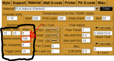

I am incredibly frustrated at this point. I have NEVER (n over a month) managed a complete large print (I have done a few small objects).
Every time at some point the hobb wheel gouges into the filament and will not push any more.
I have tried both ABS and PLA from two different high quality vendors at a wide range of temperatures.
I have carefully measured the filament and even artificially adjusted the diameter to lower the feed rate.
I have calibrated feeder steps again and again.
I replaced the hot end tube fan with a bigger one and have it running full speed
The feeder is NOT "hopping" or clicking
My prints look really good, no blobs or excess material
It prints along just fine and then just stops feeding and every single time I find a divot in the filament.
Seriously I am ready to throw this thing out the window.
If anyone can help with additional ideas on how to fix this I would really appreciate any ideas.

I manually ran the python script that enggmaug provided (thank you) against an offending G-Code and it cam back with "Clean Code."
I checked the hotend temperature with a Fluke Thermocouple and it was +/- 2 degrees C of what the thermistor reads
I totally disabled retraction just to see if constant retraction restore acceleration were the problem
I checked that my steps per mm in the firmware is 92.65
I carefully dis-assembled the hot end and the ptfe tube is fine and no gaps or clogs.
The filament diameter is accurately set (I rounded up even, which should feed less)
And ran another print, same thing
I am totally convinced that filament is being pushed too fast!
This time I carefully watched the extruder and I could see it "skipping". Every now and then I would manually push the red spring release and the filament would spring back about 2 to 4 mm as if it were compressed in the tube. I would then push the filament by hand to gauge the pressure required and it was not excessive IMO. This release of pressure did not seem to adversely affect the print.
I tried adjusting the feedrate in Repetier but it does not seem to do anything (maybe I don't understand what that slider does).
Any further ideas???
Should I play with the Steps per MM value in the firmware? Should I artificially inflate the filament diameter value? Should I beat the printer soundly with a sledge hammer?
Thanks for the help
RKM

what spped are you using i was at 55 and man that was fast moving cutting action i am now going to try 20 and 2mm suck instead of 10 or ??? setting does one recomend.
Ian
Ian
