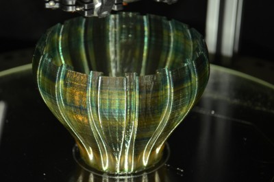

just can't get the photo to show how awesome this looks.

what were you speeds and temps?
looks pretty good to me!
Zerosink
Posts: 34
Joined: Thu Aug 01, 2013 4:44 pm
Re: T-Glass Vase
Post by Zerosink »
30 mm/s, 215 hot end, 60 on the bed till the bottom 3 layers were down then dropped to 40 for the rest of the print.
0.3mm layer, vase setting in Slic3r.
It has a hologram effect to it, changes as you tilt/turn it.
I am very happy with it :)

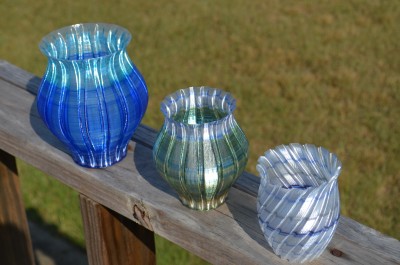

Ummm... I use a Sharpie :)
If you mark only 1 side of the filament it gives a really good optical effect as you tilt it up/down.
Diff effects depending on what side you mark. Colors may change when you print, red sharpie makes a good Gold :)
You can see the color through the clear part of each layer.
I can "see" through the tikiman... but can't make the picture show it.

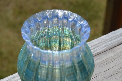

Backlit with a white LED and tilted a bit.

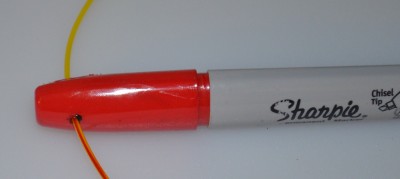

OK... I just couldn't splain how good this colored t-glass looks :)
This is how I sharpie-colored the Tiki man t-glass.
In the photo I used PLA for its contrast. You can see it is a small thin stripe.
That lil thin red stripe made the gold color on the tiki man.

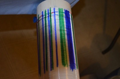

To color the wine bottle in the video,
I wrapped the clear t-glass around a 4inch pvc pipe and colored it.
The print .. well the green didn't show that well, but anyway :)
I don't think I would do it this way again.
