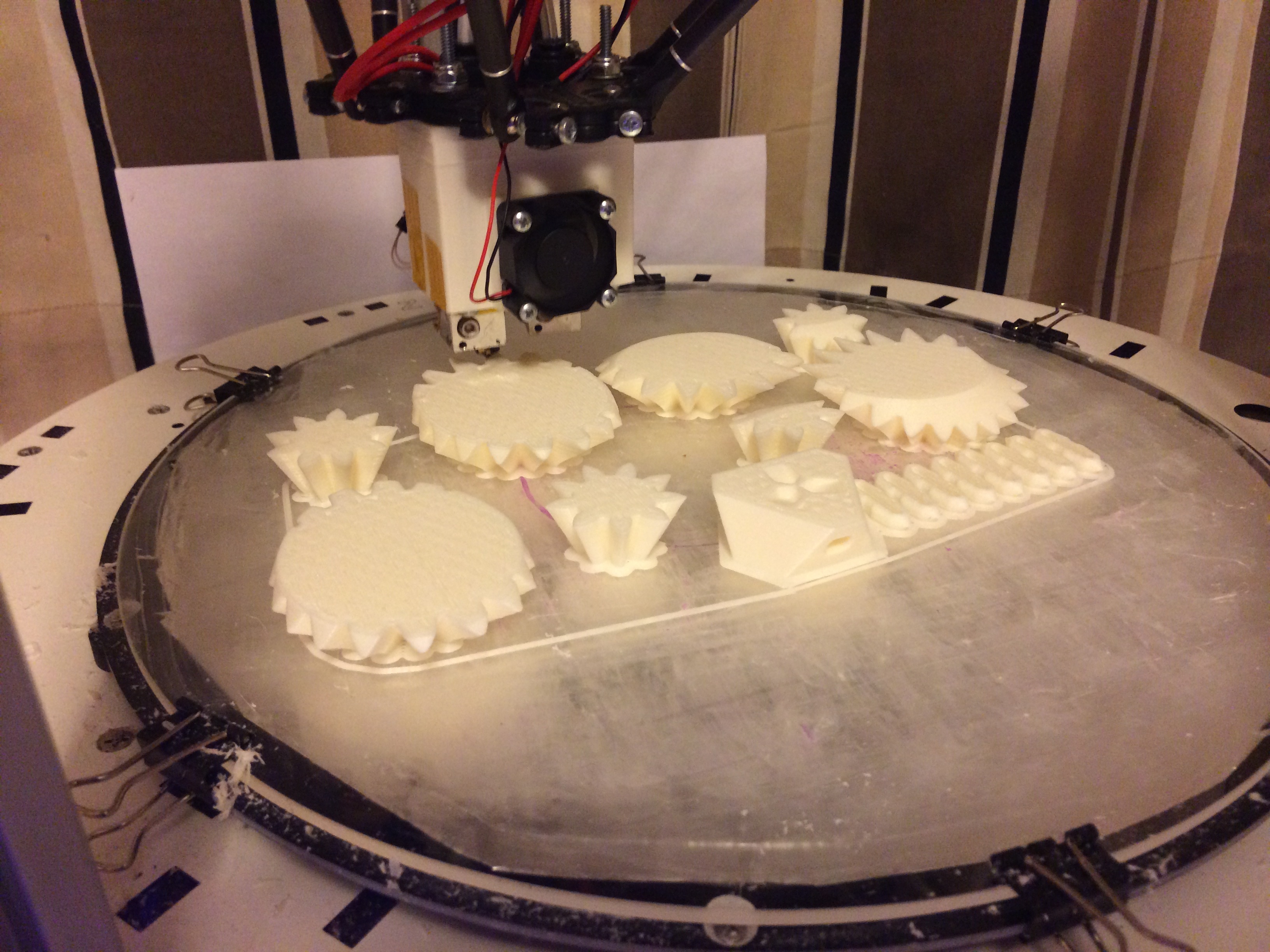

I figured with Valentine's Day coming soon, that I'd print one of these: http://www.thingiverse.com/thing:243278.
Some prints in progress:
In progress
In progress
Finished on the bed.
The finished item (which was tricky to assemble, even while watching the video :-P):
Final item assembled.
I printed in White ABS (Jet, ordered from Amazon) at 240C with an E3D, 0.4mm nozzle and Gluestick on 100C bed. Here are my slicing parameters if anyone's interested. Note that I increased the speed multiplier to 150% after about 5 hours of printing and then I increased it to 200% after about 7.5 hours of printing. I'm not sure how long it actually took because I went to bed :-). It was 75% done after 8.5 hours of printing according to the LCD.
