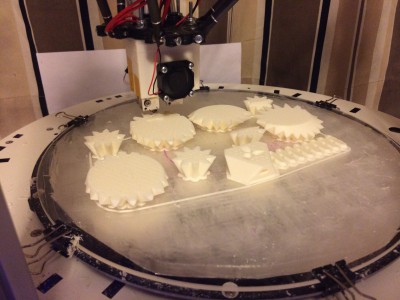

Some prints in progress:

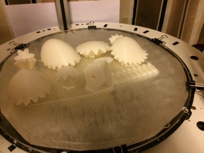

The finished item (which was tricky to assemble, even while watching the video
I printed in White ABS (Jet, ordered from Amazon) at 240C with an E3D, 0.4mm nozzle and Gluestick on 100C bed. Here are my slicing parameters if anyone's interested. Note that I increased the speed multiplier to 150% after about 5 hours of printing and then I increased it to 200% after about 7.5 hours of printing. I'm not sure how long it actually took because I went to bed
; generated by Slic3r 1.0.0RC2 on 2014-02-10 at 13:15:43
; layer_height = 0.2
; perimeters = 3
; top_solid_layers = 3
; bottom_solid_layers = 3
; fill_density = 0.2
; perimeter_speed = 30
; infill_speed = 30
; travel_speed = 200
; nozzle_diameter = 0.4
; filament_diameter = 1.75
; extrusion_multiplier = 1
; perimeters extrusion width = 0.44mm
; infill extrusion width = 0.44mm
; solid infill extrusion width = 0.44mm
; top infill extrusion width = 0.44mm
; first layer extrusion width = 0.60mm
