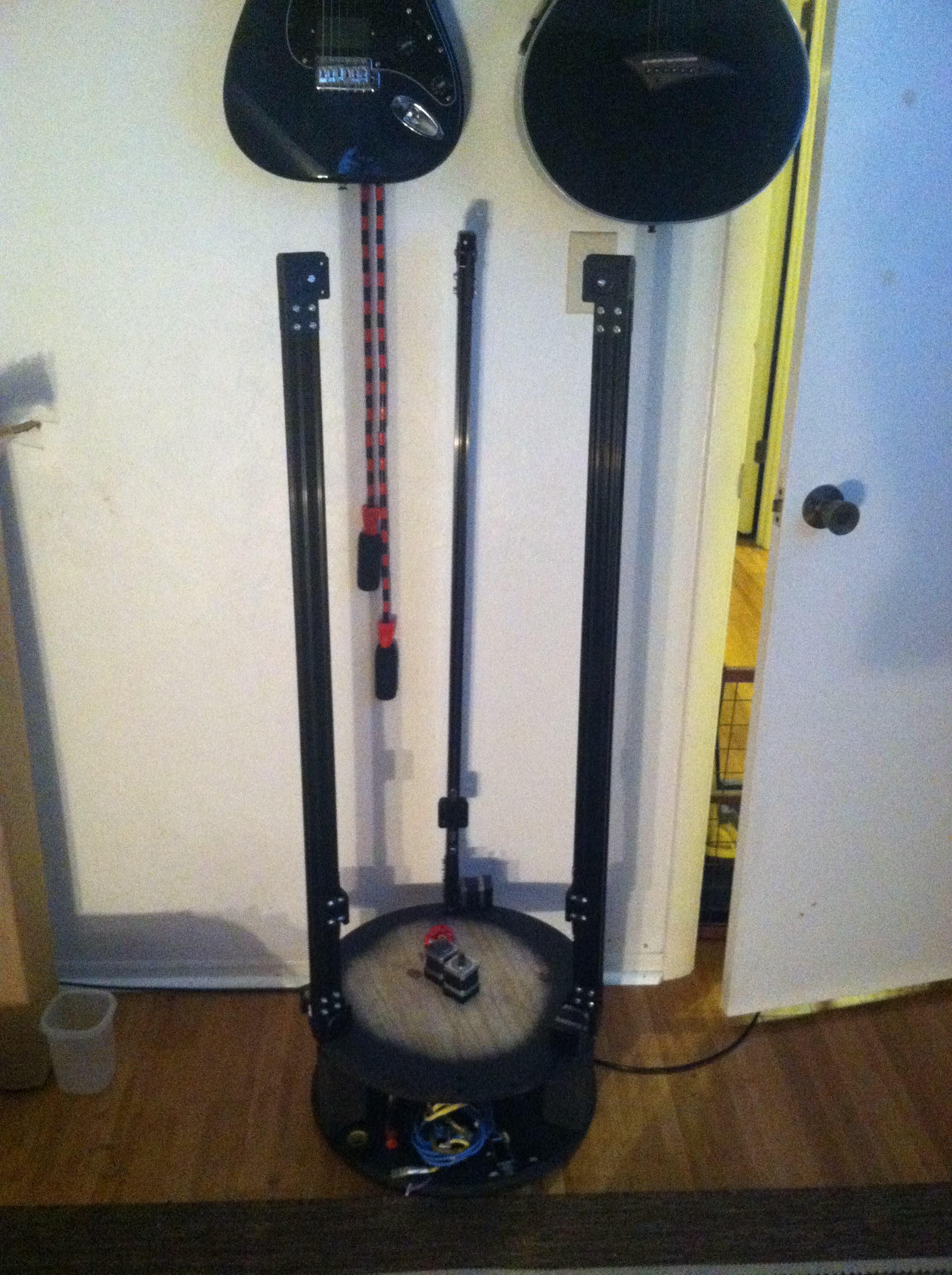

Hello all,
I recently caught a bug for 3d printing, and as i learned more about them i saw they had small print volumes. And well bigger is always better, right? So I stumbled onto delta style printers, and loved the simplicity of their movement. Though all the manufacturers build volumes were less than what i wanted. So i decided to build my own. The remainder of the parts are on the way, The top is going on tomorrow.
the linear height is 39.3inch(1000mm) while the round wooden base is 18in.
And i would love any suggestions if you guys have any.

I got the top put on today, and some LED lighting.
Here is the motor wired into a CAT5 cable. I plan on using the plugs as a quick disconnect.
it has a 15 tooth pulley and a heatsink on the back.

The top, heater plate and bottom are $5.00 table tops from Home Depot. 18 diameter.
I grabbed a outlet box and a 6slot cat cable plate. I cut the cable in half and soldered the pairs of like colors together. Eg) orange w/ orange and white. Then assigned each to either A+ A- B+ or B-.
I think it will be helpful as I'm building as I go.
It just spray painted too.
I'm going to be building a resistor based hot plate for it too.
