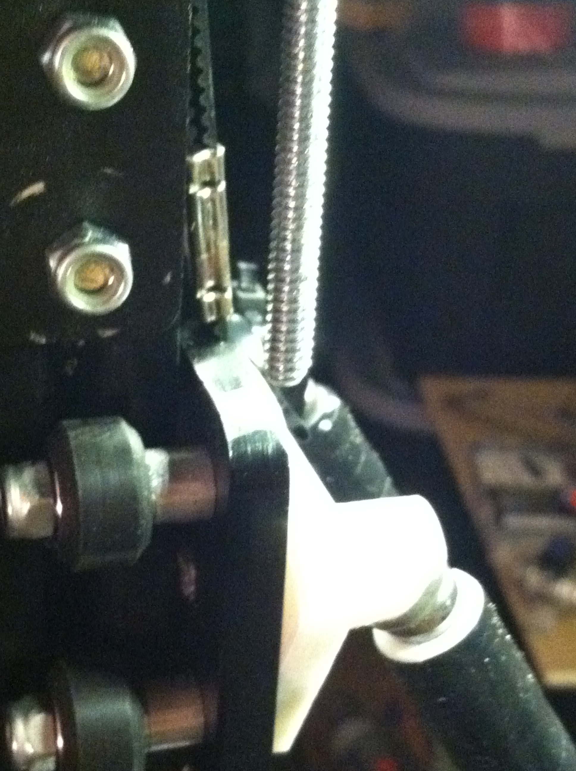

I have added a z probe that originally started as a salvaged microwave oven switch. The switch i noticed had measurement deviation of .5mm (+-) I dont know whether all switches are that bad, or just mine. And i had a light bulb moment and turned my whole heat bed into the switch. Seeing as i have a aluminum bed, i just negatively charged the bed and positively charged the probe. Now the deviations are .03+-
After that worked well i decided to apply the same idea to the linear carriages. I ran a all thread rod through the roof and soldered a positive wire to the threaded insert. Then I attached the negative wire under the phillips mounting screw. I had to file off the anodize around the contact area to close the connection. The wires are a little unsightly atm, but I'm gonna clean it up after it starts performing.
