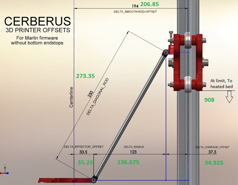

She isn't as busty as I wanted, but she has some nice legs! lol
And picked up a new Mega and it recognizes and uploads.
Working on firmware now. Results not inspiring....

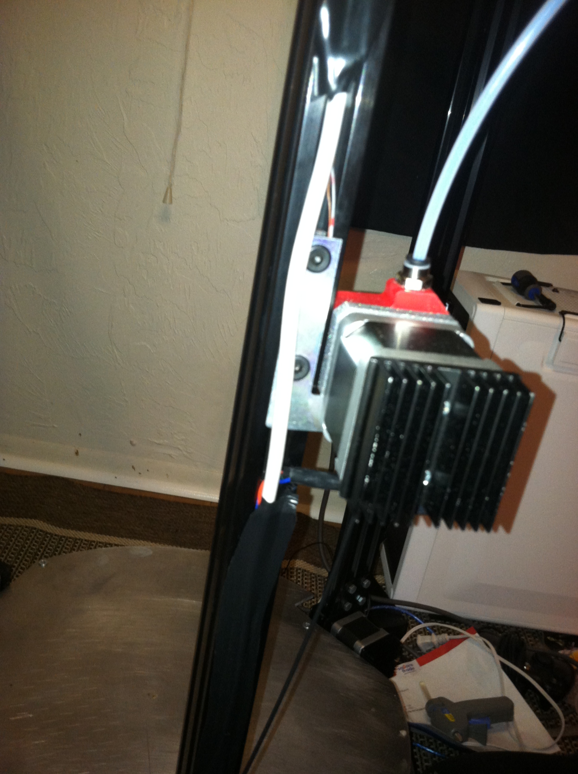

I haven't posted in a bit but i have still been working non stop on it. This is how she sits.
Iver mounted the extruder a little under half way down the rail.

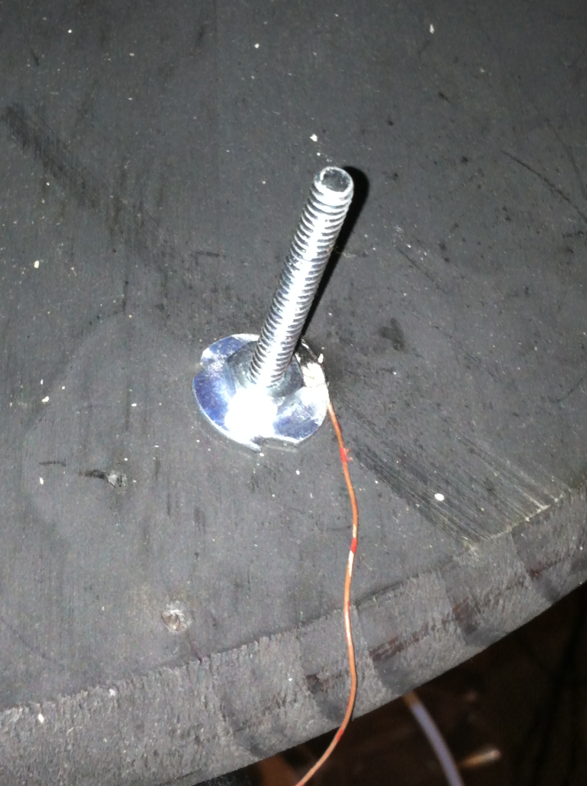

I have added a z probe that originally started as a salvaged microwave oven switch. The switch i noticed had measurement deviation of .5mm (+-) I dont know whether all switches are that bad, or just mine. And i had a light bulb moment and turned my whole heat bed into the switch. Seeing as i have a aluminum bed, i just negatively charged the bed and positively charged the probe. Now the deviations are .03+-
After that worked well i decided to apply the same idea to the linear carriages. I ran a all thread rod through the roof and soldered a positive wire to the threaded insert. Then I attached the negative wire under the phillips mounting screw. I had to file off the anodize around the contact area to close the connection. The wires are a little unsightly atm, but I'm gonna clean it up after it starts performing.
And thank you Apollyon25, Ever since i read your post ive been paranoid. I Tried to test it today, and there was some smoke.......... and then the resistors stared falling off the plate. So i had to abort the launch sequence. I'm going to switch over to a silicone heater. All this work i would hate for it to catch on fire. Now to find a use for 50watt resistors...
