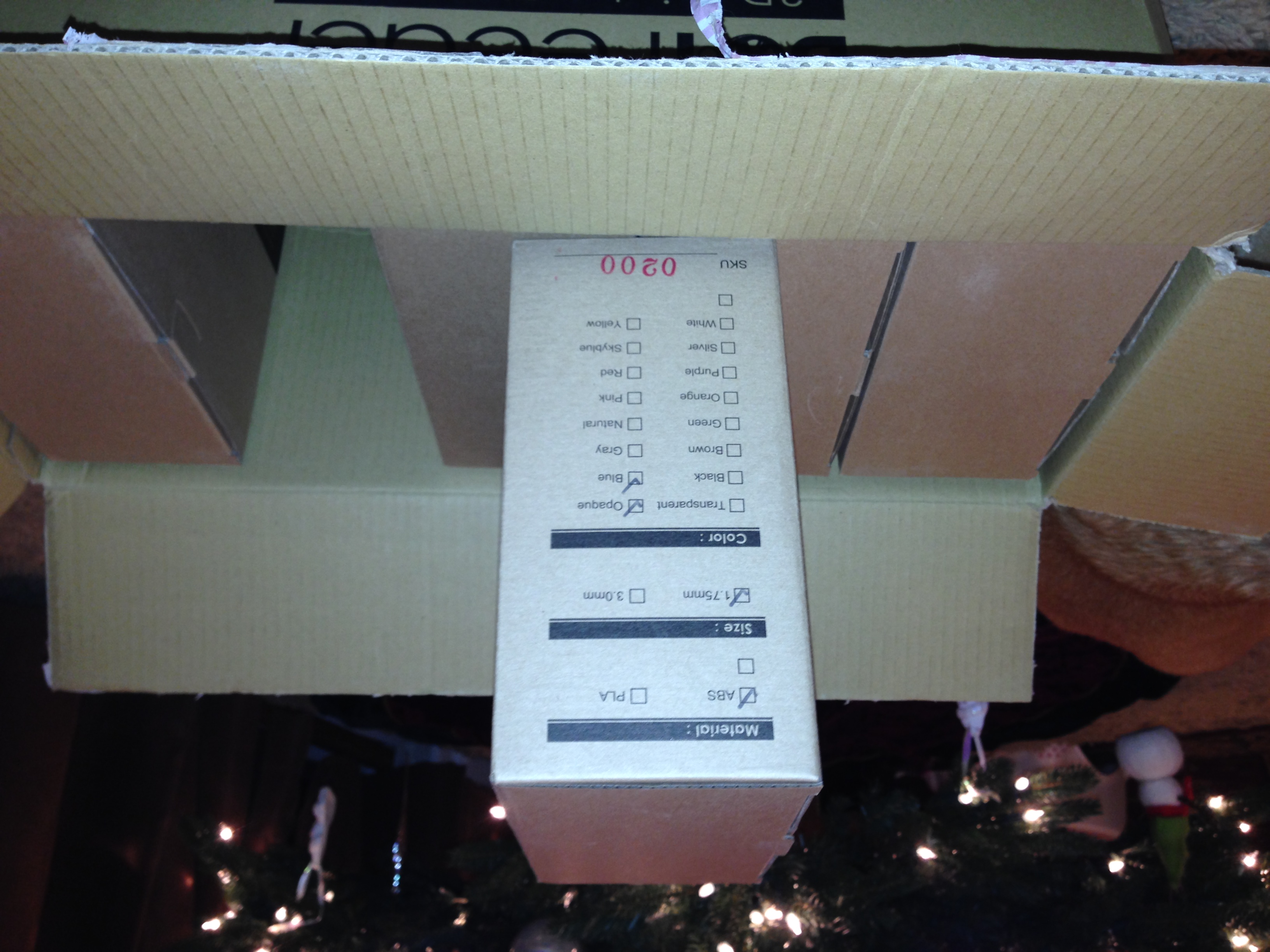

Packaging:
1) The boxes arrived nicely packed in two parcels.
2) Inside each box were 5 individually boxed spools of filament.
3) Each individual box is labeled with its contents in the event you want to store them in the boxes.
4) Each box contains a shrink wrapped spool which also includes a deca pack.
Thoughts…..
1) Botfeeder has done a very nice job protecting the spool during shipping.
2) The individually labeled boxes are nice and make storage easier.
3) The shrink wrapped spool with a deca pack is a nice touch.
