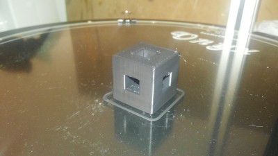

Unfortunately my multi meter is old and doesn't have the ability to read a thermocouple probe, I did try lowering the hot end temp to 220C and the bed to 85C and it was able to get up to those temps and start printing, so far it seems to be working fine, I will check the thermister after it finishes the print though.

I will say those I'm very happy with the results of the first print, came out better than I was expecting from seeing what some other people's first prints looked like

That looks fantastic for a first print! Well done!

The cube looks great
