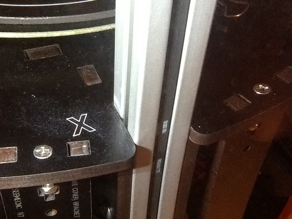

Sandtoe
Posts: 12
Joined: Tue Feb 11, 2014 10:10 pm
Re: Rostock Max assembly
Post by Sandtoe »
Hi, I built mine in January and I sort of had the same thought. These pieces don't seem to match exactly and I am trying to remember if mine where off by 1mm or so. I think they may have been. It is the depth and not the width as there are more pieces to the top than the bottom. Couple of pics may help. You can adjust them a small amount front to back in the slots also to make sure they are straight up and down. Mine fit without much adjustment.
Lower part and tower
Top piece and tower
Top piece and tower

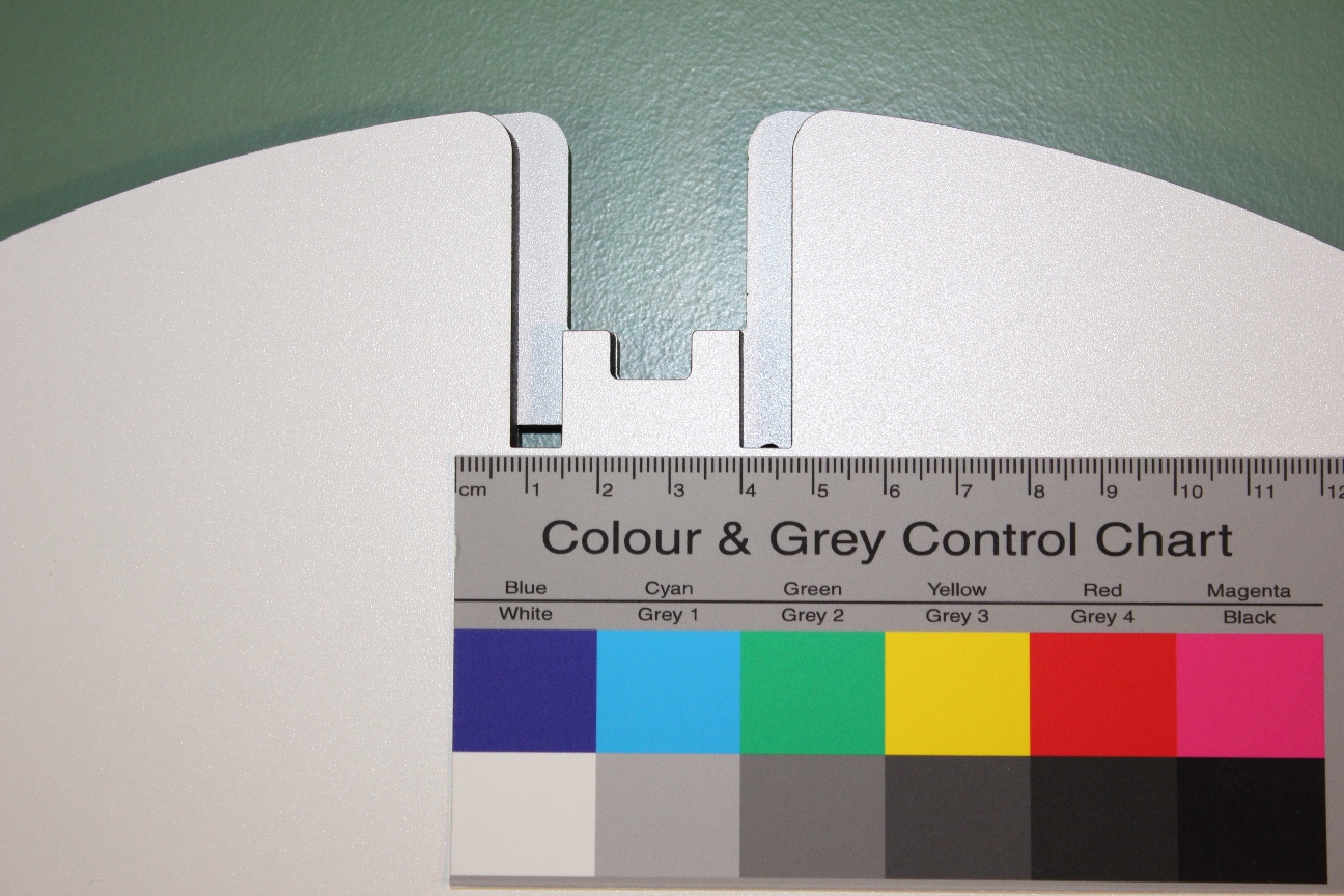

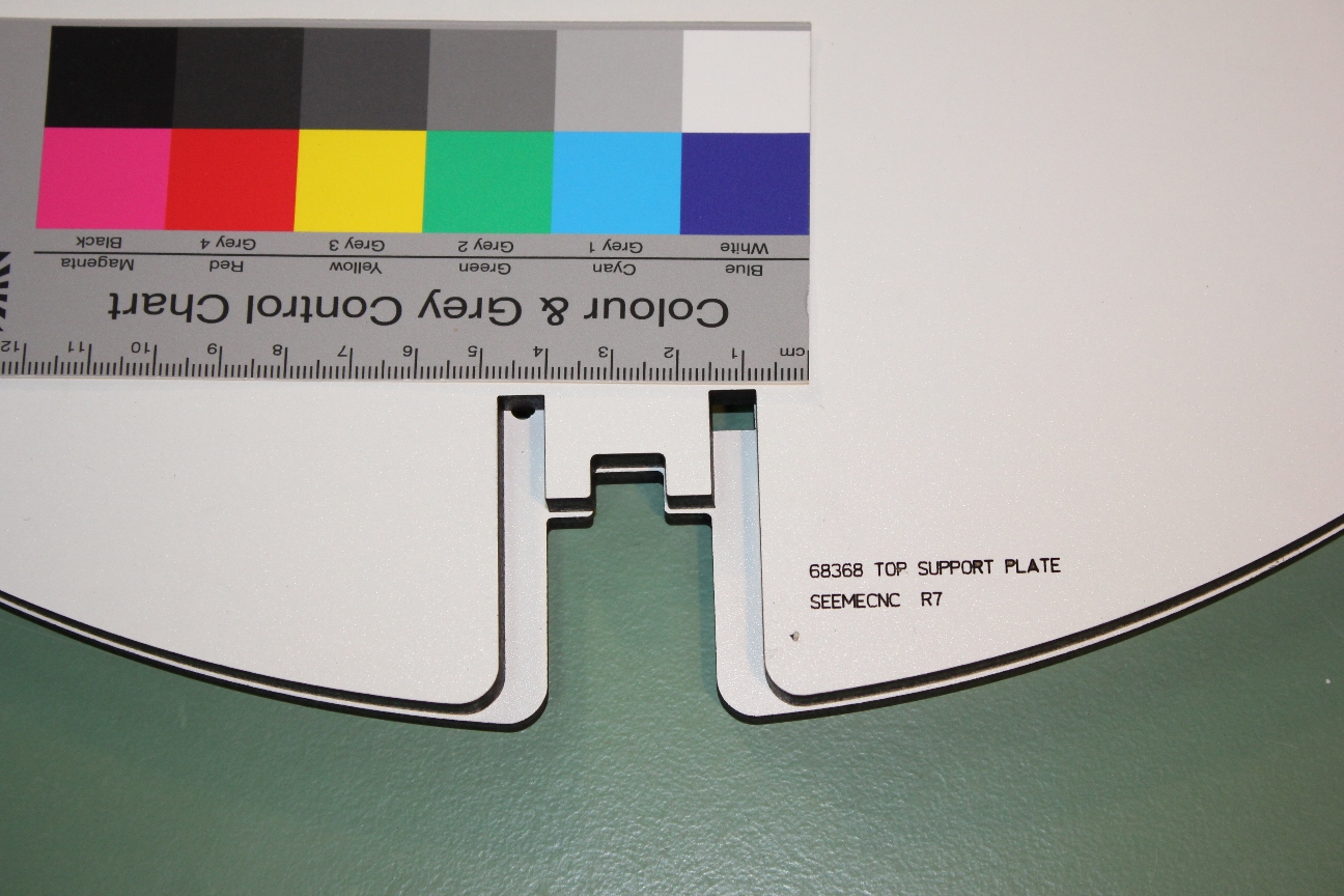

JolietDelta
Posts: 17
Joined: Sun Jan 05, 2014 8:39 am
Location: Stuttgart / Germany
Post by JolietDelta »
When I built mine I encountered the same problem (see the pictures below).
I decided not to rely on the both plates beeing exactly the same, but on the heated bed beeing exactly 90° to the towers. This is ok as long as the circular alignment is right (which it was in my case).
Nevertheless I sanded the bottom plate (the one which had a slightly elliptical shape) to match the top plate. Just in case. :-)
Top/Bottom plate, matching side.
...and the opposite side.
Using a good bevel gauge which helps you to adjust the three towers to be exactly (!) 90° (and this in both, X and Y dimesion) to your heated bed, is more important than having exact matching inner faces of the both plates. IMHO.
~Jens
Posts: 5358
The towers should be square to the BASE, not the heated bed.
There's enough error in your plates that I would have contacted SeeMeCNC about it and asked if that was within tolerance.
