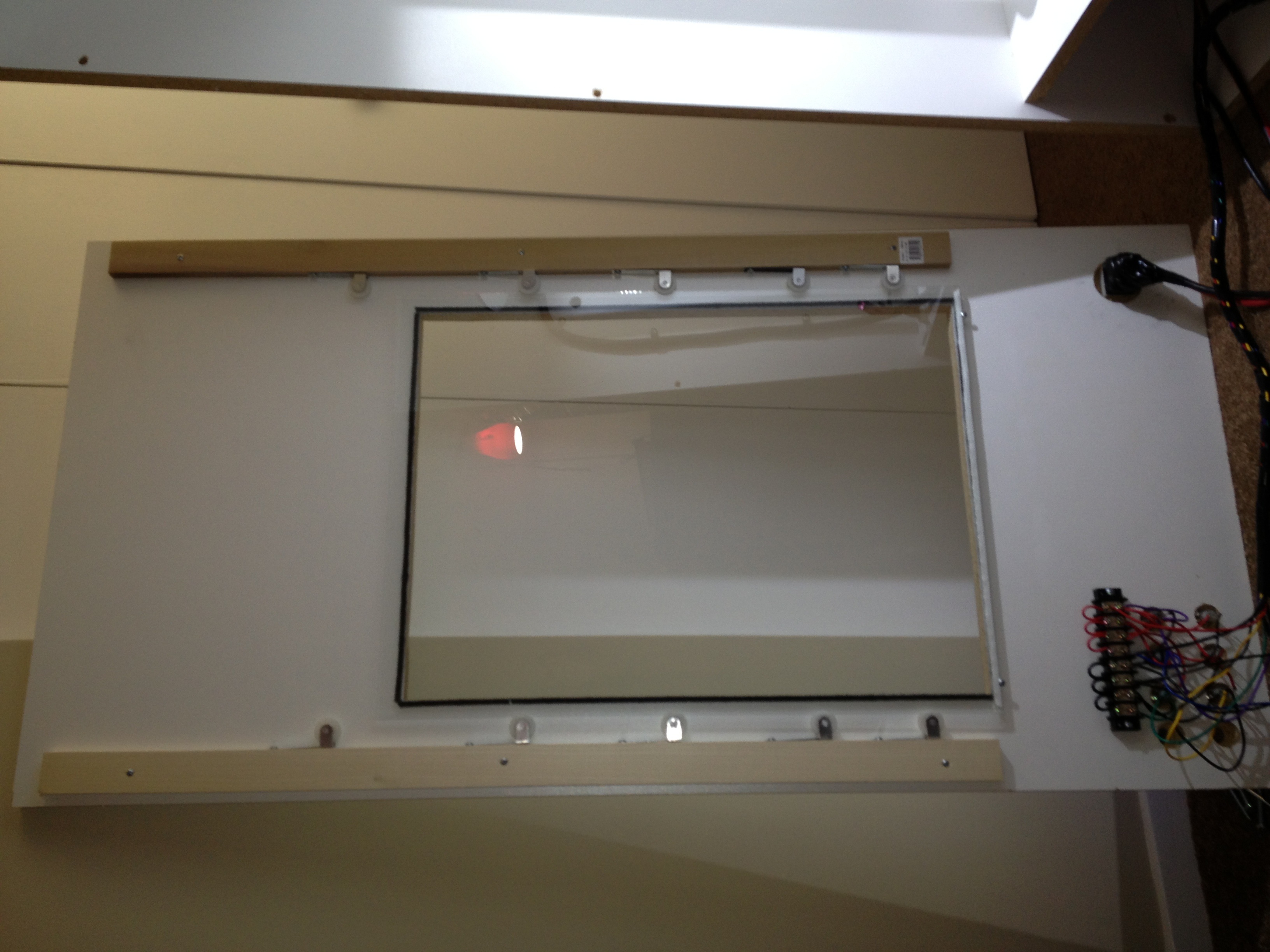

Going to hook up a arduino separate to the printer. This will allow my glass window to open and close with a push button, stepper motor, limit switches. Ect. May also use it to control temps inside the case or other needs.

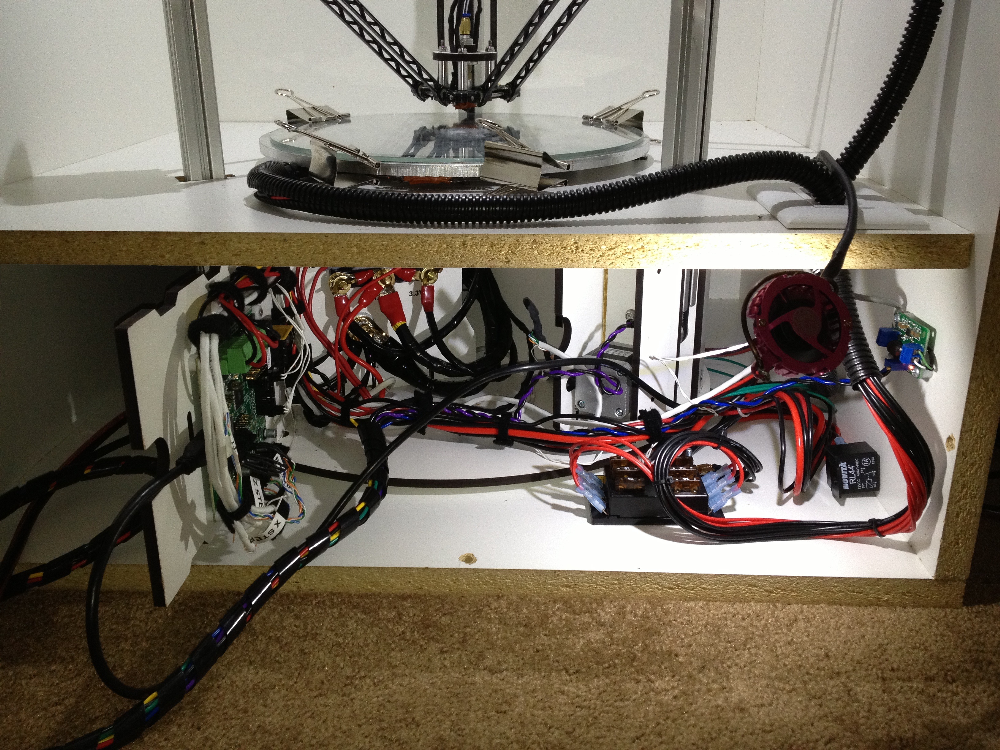

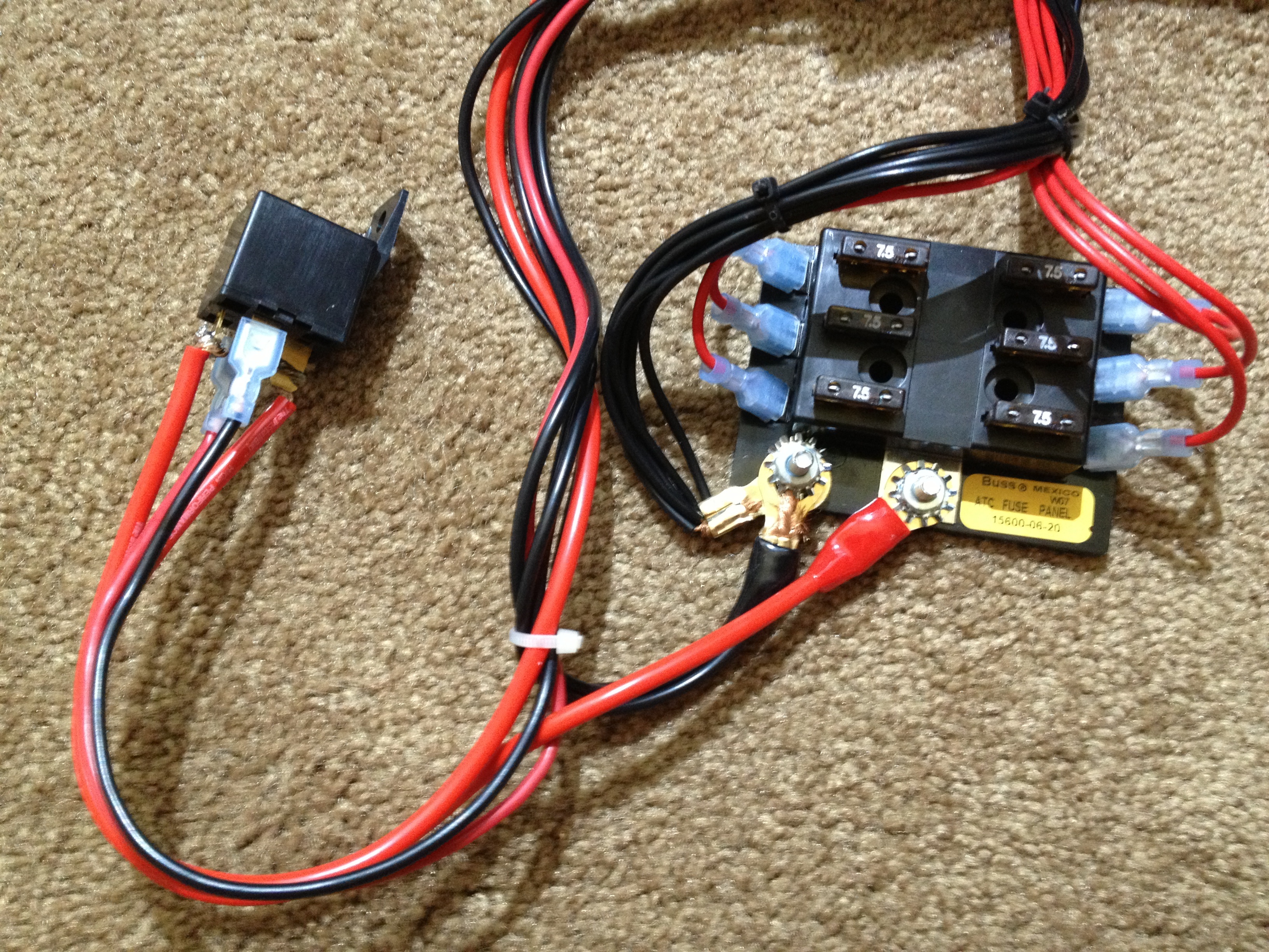

Since I upgraded my power supply which is still 12v but almost 60amps now I beefed up my heating bed with mic-6 and around 300watts to heat it up. Takes about 15 mins to get to 100c which is still longer than I thought but not bad! Before with the onyx under it took over an hour for that big mic-6.
This is also on a relay to the Rambo.
Can level the bed with screw adjustment so far no problems with heat.
Had to fill in the slot that I cut out for the onyx. So just put some blue leds on one of the heating elements so I know when it turns on and off. : )

The buttons are for power, reset on Rambo so I don't have to take the front cover off all the time and two are for my 10 watt leds. One at the top and a adjustable one on the side. Two buttons are spares and the blank two holes will be for up and down buttons for the glass window which I'm impressed with. It seals pretty well from the room. Just need to rig something up to move it. I'm thinking a timing belt stepper motor and some limit switches on an arduino will work ok. Will upgrade to better extruder soon. Relay for bed. Each one is fused I have a little bit of clean up with wires to do...

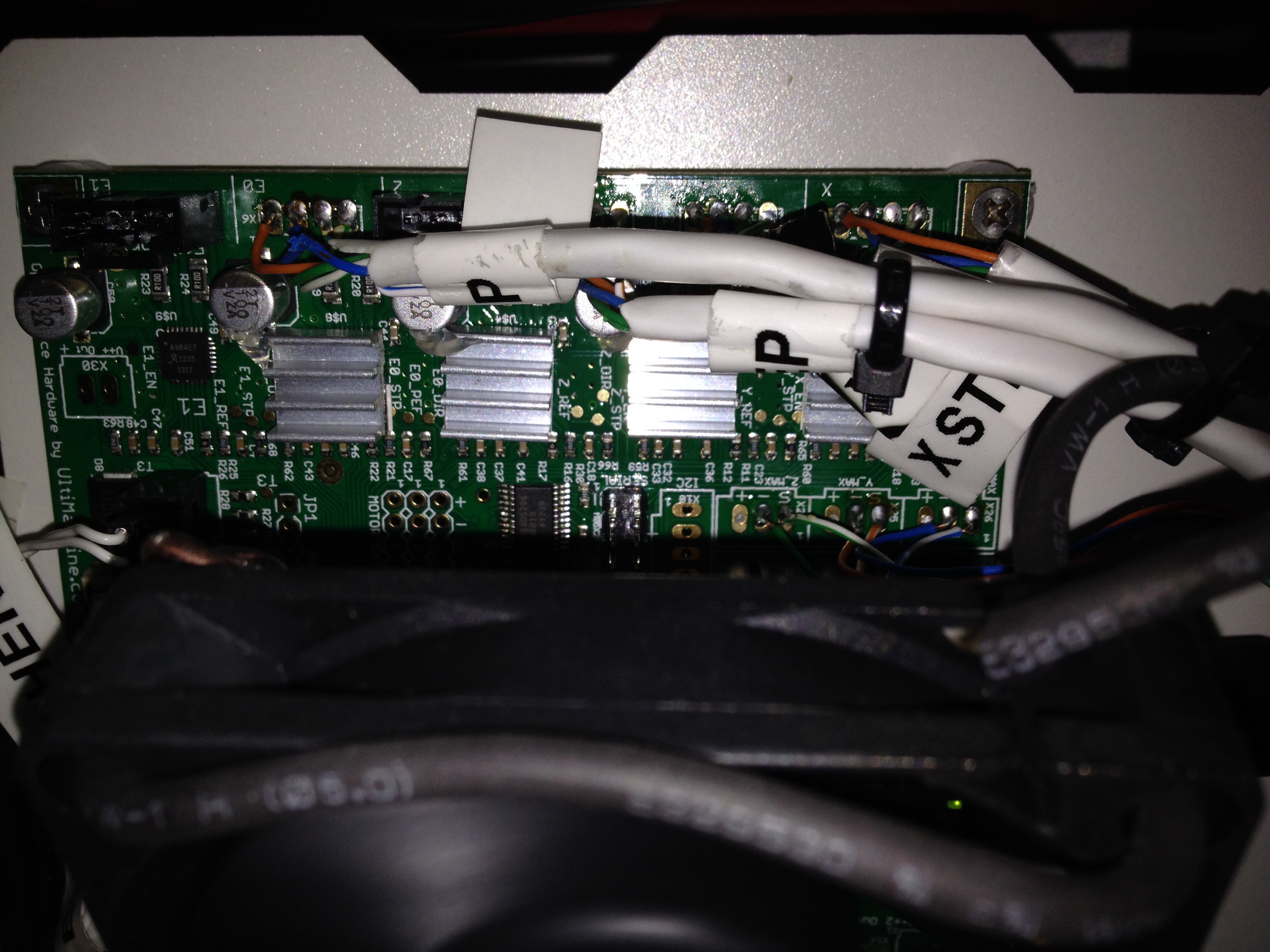

Can I ask why after all that work, amazing btw, you don't have an lcd controller mounted outside that box?
							Purple = sarcasm
Re: My printer is almost complete
Because I bought this in December. Tried many ways to get the thing working right with Rambo. Don't know if it was a lose wire. Something was backwards or the firmware.
So I said I don't need you anyways... Haha
Been anti ever since.
I like using host on my 32inch pc screen. I have a dual video output on my graphics card and had a old thick but decent size pc screen laying around maybe 17 inch. Ended up being to heavy, thick, and just really had no place to mount it. I thought about putting it on a hinge and mount on the side of the box or something. Just felt like overkill. I got it from work. So it's old school but was very expensive at the time. Maybe $1500

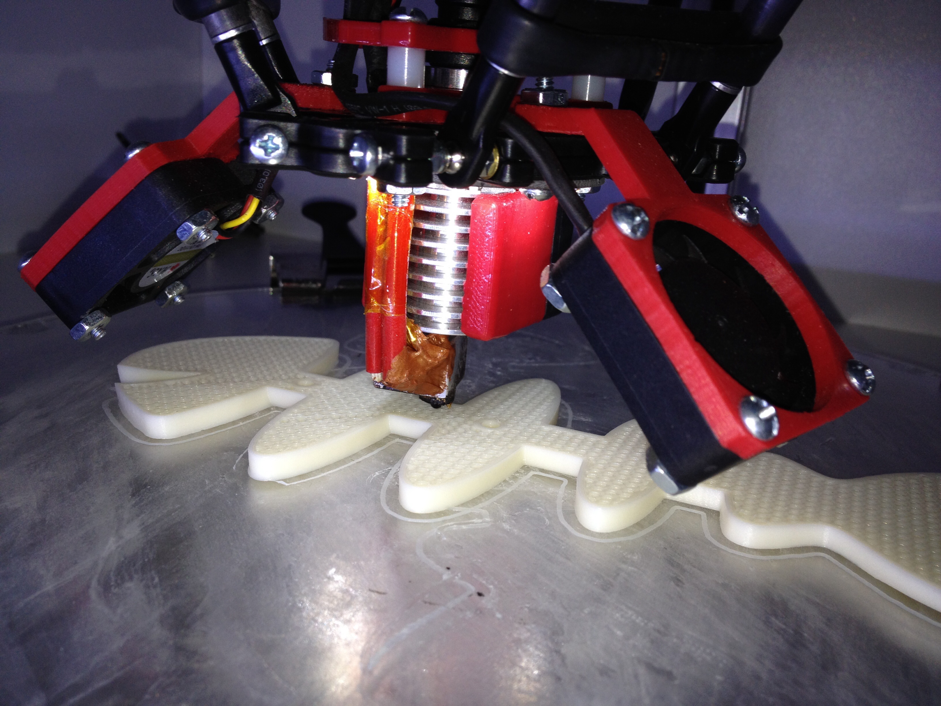

- A lot of mods in this picture. The best one is my added support to the frame of the rostock. I noticed it was not too sturdy and questioned it. So I built these which are pretty adjustable to where it really helps me align my towers. With this and the adjustable aluminum bed things are pretty accurate all the way up. I Printed and installed the belt tension set shared on this forum. Installed a centrifugal fan with a carbon filter to eliminate odors. It also can be wired later to do more like control the temps inside.

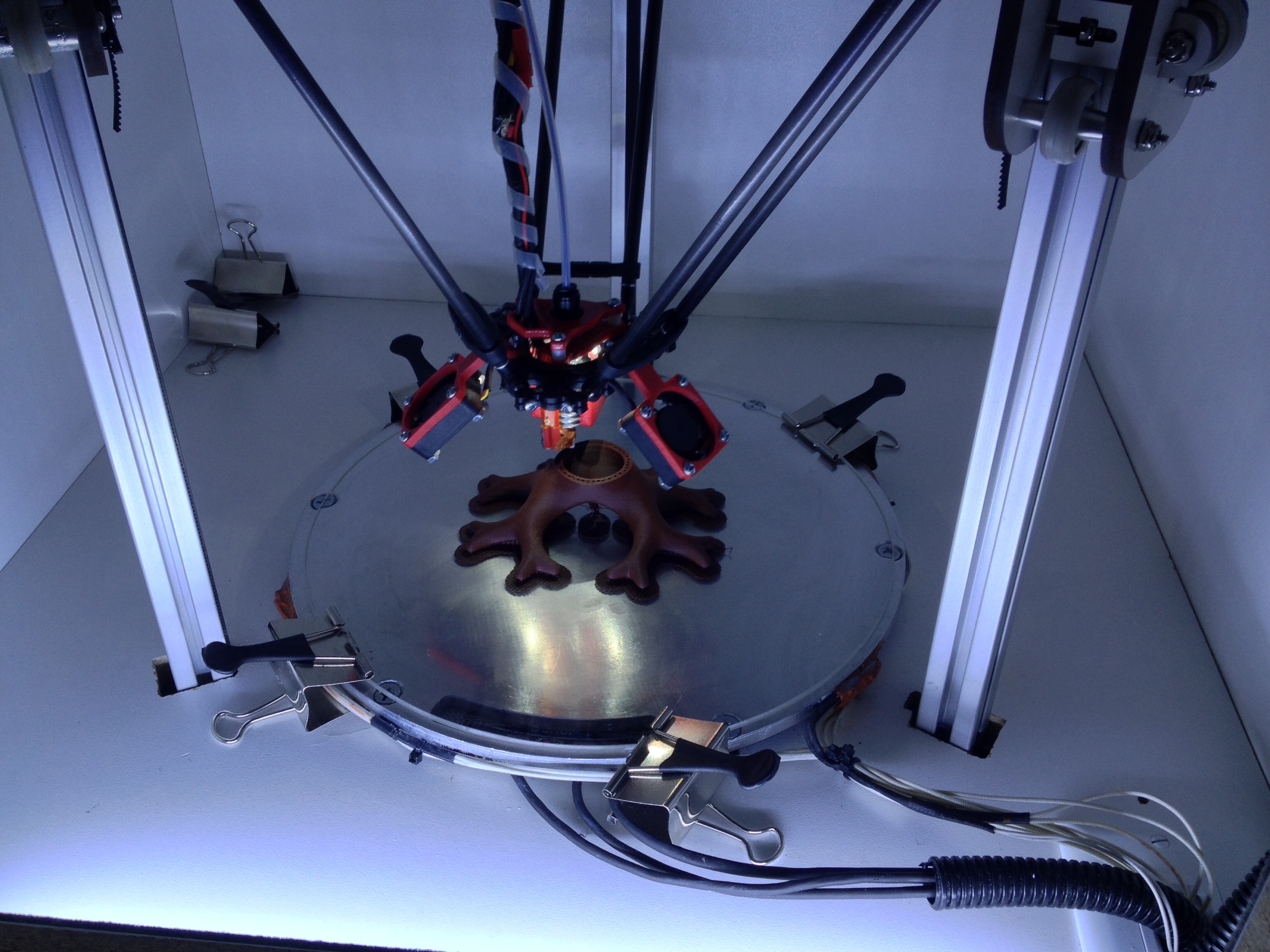

- This is a good picture to notice the added heating elements. I have 5 40w heating elements normally used for hotends installed into the aluminum bed for faster heating times. They are on a cheap relay kit sold on seemecnc. I did install the onyx back under the aluminum to get very even temps along the plate. The onyx takes over after a few temps from the outer heating elements.

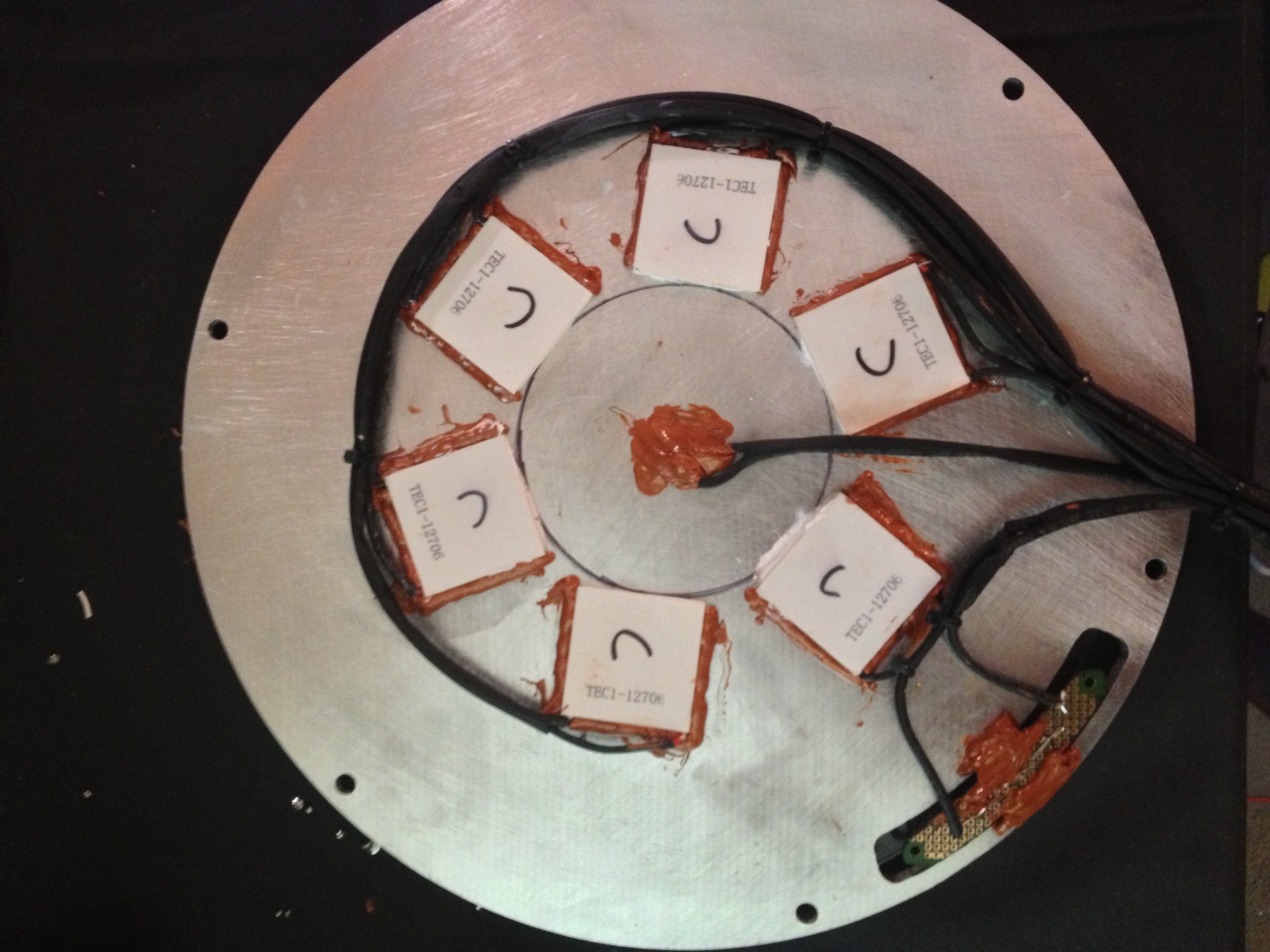

Re: Update 2-26-14 My printer is almost complete
thenewguy, great job on the printer. Looks fantastic and also seems to work great.
I'm confused though:
Why choose peltier elements for heating?
How are you even getting 100C from them?
Seems like a 110V coil wire would be much more efficient then the peltier elements, no?
The peltier elements worked. I had it to 105c with less effort than the onyx. However they lasted a few months and started to lose preformance. It also created hot spots on my bed. Even with that big piece of aluminum.int2str wrote:thenewguy, great job on the printer. Looks fantastic and also seems to work great.
So now I have the onyx underneath set to 100c on the pid. I then installed 5 40w heater like in the e3d on another relay/controller set to around 95c. I can get my bed to 100c in around 25 mins now. Not as fast as I want but it's not easy either.

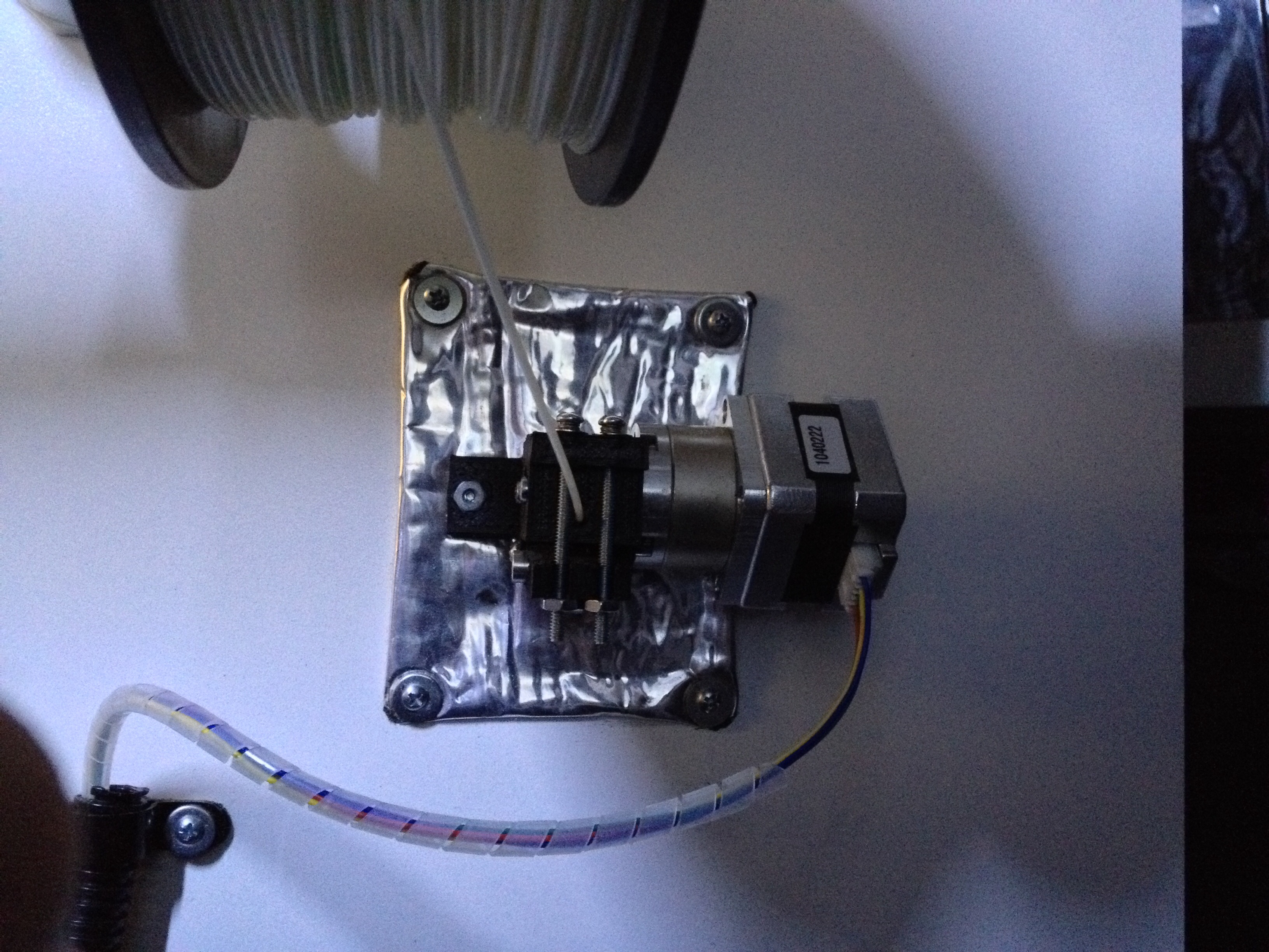

"This is a must have upgrade for your machine. Geared motor and really grabs the abs. Very accurate!"
Did you get the plastic portion from Thingiverse and if so do you remember the number?
I don't think I got it off of thingverse. I believe I have the file on my computer if you need it though.Eaglezsoar wrote:"This is a must have upgrade for your machine. Geared motor and really grabs the abs. Very accurate!"
It would be nice if you can find the file but don't spend a lot of time searching if you are not sure where it is.
The one that you are using looks good and has already been tested by yourself, that's why I asked.
