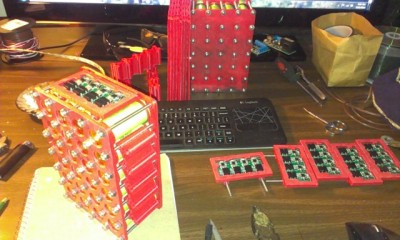

i have 4 weeks to have this electric motorcycle converted for the race, and i need to print some more stuff before i can finish this battery pack. and then finish wiring the bike. im soo close, but this is a very abrupt halut im facing...
you can read and see more about the packs at http://www.advancedmagneticpropulsions.wordpress.com
