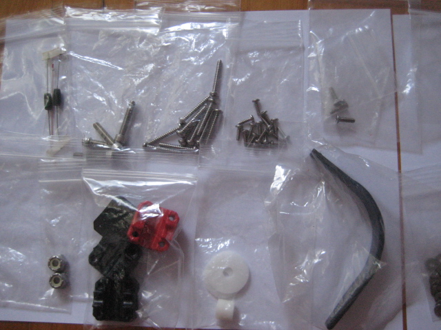

I recently bought a SeeMeCNC and wonder if I assembled correctly because after I've finished, there are a lot of tools left. I wonder if I've missed anything? Please advise.
Thank you very much,
Here are some pictures of the final product!
Extra units

I just finished assembly of my kit and I have almost the same leftover parts.
Re: Extra units
What is the black thing like a C use for?
Re: Extra units
I had parts missing and lots of extra parts after i finished mine. I didn't get that c shaped thing. Wonder what it is for. I did get the biggest Zip-tie I've ever seen, but don't know what it is for either.

I just received my kit today and counted everything into spare plastic parts boxes for the build. No mystery C-shaped object and no zip-ties of any size. Going off the parts lists, I have a few extras on all the sheetmetal screws, including a couple 1/2" screws that were in the 1" bag. A few extra washers too. Everything else matched exactly.
