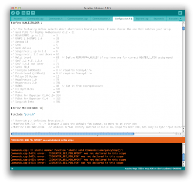

A day of frustration
Well, I'm trying to make a final push to get my Kraken upgrade finished. I made a lot of progress on wiring and getting ready for the swap to the new Azteeg X3 Pro - and that is where the pain began!
I finished soldering the connectors on the X3 pro, checked my work under a magnifier and then installed the 8 stepper drivers. At this point, I wanted to upload Repetier and start testing.
Problem 1: the Repetier .91 release that we've all been using does not compile if you set the board type to either RAMPS (board 33) or Azteeg X3 (board 34). You get some odd errors:
Code: Select all
Commands.cpp: In static member function 'static void Commands::emergencyStop()':
Commands.cpp:1423: error: 'DIOHEATER_BED_PIN_WPORT' was not declared in this scope
Commands.cpp:1423: error: 'DIOHEATER_BED_PIN_PIN' was not declared in this scope
Nowhere does DIOHEATER_BED_PIN... appear anywhere in the sources?! I've looked several times. Anyway, I fetched the latest point release .91.7 and it compiles just fine with board type #34. Progress, almost...

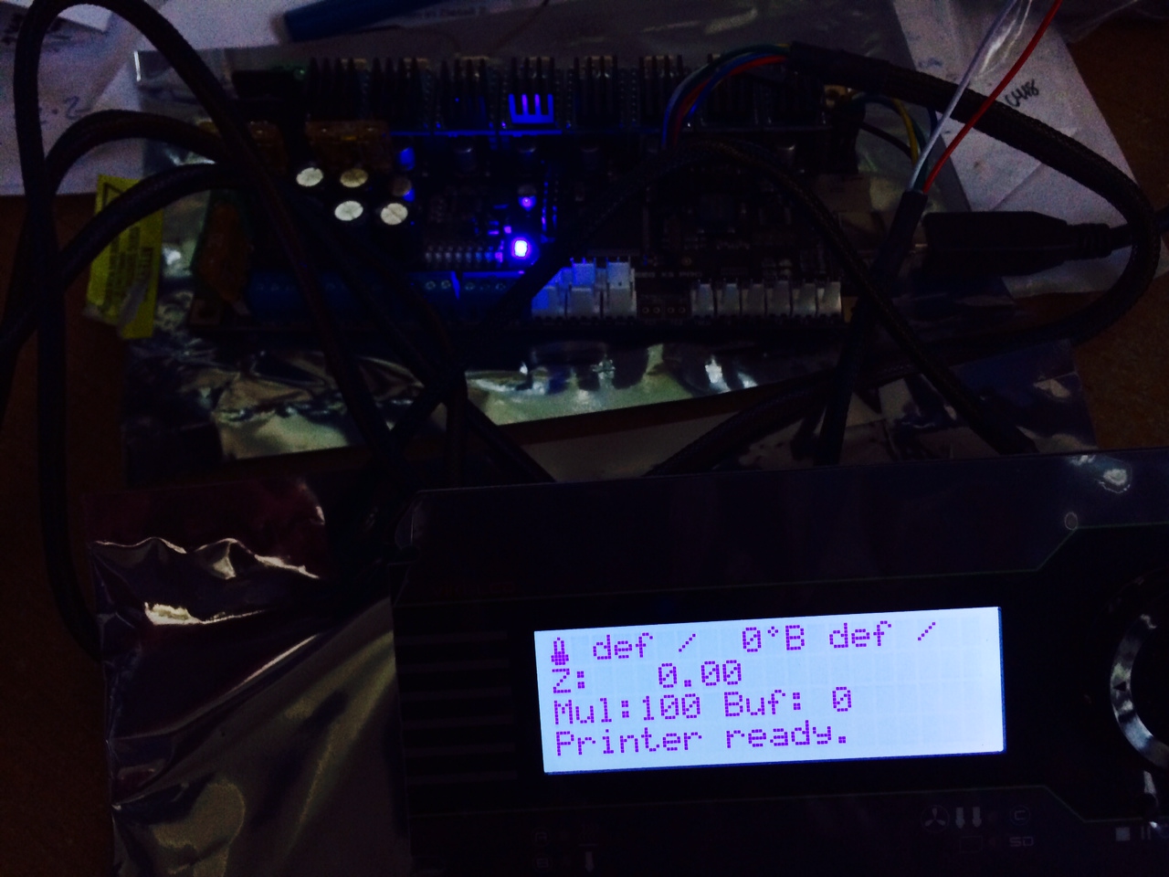

Problem 2: I've been having issues connecting to my RAMBo via USB since upgrading to Mac OSX Mavericks. There are so many problems with Mavericks in odd areas. Turns out Apple changed the USB drivers and that is causing all sorts of problems. But there is a published work around.
After disabling the Apple driver and reinstalling the virtual driver, I rebooted. I was able to connect to RAMBo but I almost always could after a reboot so it is too early to tell if it will work long term.
Problem 3: Now with the usbmodem serial port working again, I connected the X3Pro and attempted to upload the firmware... And immediately ran into a timeout problem uploading: avrdude: stk500v2_ReceiveMessage(): timeout A google search turned up a lot of info that this might be caused by sequences of "!!!" (there ! marks) in the source code. Go figure, this sequence was used in the Arduino boot loader to enable the monitor or something. Silly. There is an updated boot loader (this looks like a several year old problem) or you can remove the "!!!". Turns out the Repetier source has quite a few places where the developer gets overly excited and has sequences like "!!!!!!!". So I removed them all and tried again. Things looked a little better, the Tx/Rx LEDs on the X3 flashed quickly for a few seconds then went dim a another timeout error appeared. I found a couple of posts on the Arduino forums about turning on verbose upload logging and checking it for sequences of "!". I did that and found no sequences, just connection failures and time outs.
That's where I am now. I've emailed Roy at Panucatt to see if he has any information. It may be a boot loader problem or a USB hardware issue that Mavericks doesn't like or handle. Tomorrow, when I'm a little calmer, I'm going to set up one of my XT PCs with Arduino and see if I can get things to work on Windows.
I should note that during these issues, I did swap out the X3 with my spare RAMBo and had no problems connecting and uploading the firmware to it. So there is something with the X3 that is an issue, either an actual problem or hardware that Apple is not supporting properly.

Hey mhackney. I use RAMPs on my MAX and forked the SeeMeCNC fork of repetier 0.91. It compiles to RAMPS and I've been using it without fault since.
You can find it here: https://github.com/gjorban/Repetier-091-ROSTOCKMAX

Thanks GeraldO - I literally did this: downloaded the source from your link, changed the board type from 301 to 33 (RAMPs) and compiled in Arduino 1.0.5 and got the same errors. I've uploaded a screen shot. I then immediately changed to board 301 and it compiles fine.

The board type in Arduino is "Arduino Mega 2560 or Mega ADK"

Oh crap. I forgot that I was working on a branch: https://github.com/gjorban/Repetier-091 ... 91.ramps14
Sorry for the confusion :)

Odd that no one has experienced this compile issue on .91 for RAMPS considering how popular it is.
Roy emailed me back and asked that I try the Marlin firmware to eliminate a variable. I did (the latest) and it time-out too. It will be interesting to see if my XP box works tomorrow.
Re: Mhackney's Rostock Max
Anyone can try this - simply set the board type to 34 and compile (DON'T UPLOAD!). I'd be curious to see if this happens to anyone else and/or on Windows.

When I made the fix to it, I assumed that it was due to SeeMeCNC's extensive modifications of the UI and possibly some Rambo dependent changes to the firmware. I haven't had the time to actually find the errant commit which causes the compiler error for RAMPS boards though so there's no finger pointing :)

Anyway, Roy had me do some tests that led to a discovery!
He wanted me to try the blink sketch. Which I did and it failed. But, I disconnect the USB and restarted Arduino and tried again. This time it worked! I then tried Marlin and it worked. I then tried Repetier .91.7 and it timed out on upload. Long story short - and through a series of tests I discovered that if I either disable the LCD or keep it at the reprapdiscount display and NOT set to the Viki display, Repetier will upload too. Marlin mentions Viki but doesn't appear to have a way to enable it (that I've seen yet). I am not sure why enabling the Viki display should cause an upload time out but it does. Now to figure out what is going on and hopefully fix it.

GeraldO, as I mentioned, I've searched ALL of the Repetier code and can not find that define: DIOHEATER_BED_PIN...
Interestingly, google it and you'll see one hit: https://github.com/repetier/Repetier-Firmware/issues/94 from 11 months ago.

Well, it turns out part of this may be an arduino / firmware issue too. I posted my problem on repetier's github and got a response that if the firmware exceeds 128kb bank, the compiler inserts bad code (i.e. "!!!" sequences).
https://github.com/repetier/Repetier-Fi ... t-37719880
Cool, looks like a fix was found and I just tested the latest as of 1 hr ago and I can upload now. My viki less flashed once and I have no display but that is likely a pin misconfiguration I can chase down.
Spoke too soon! I just hit the reset button on the X3 Pro and the Viki sprang to life!
