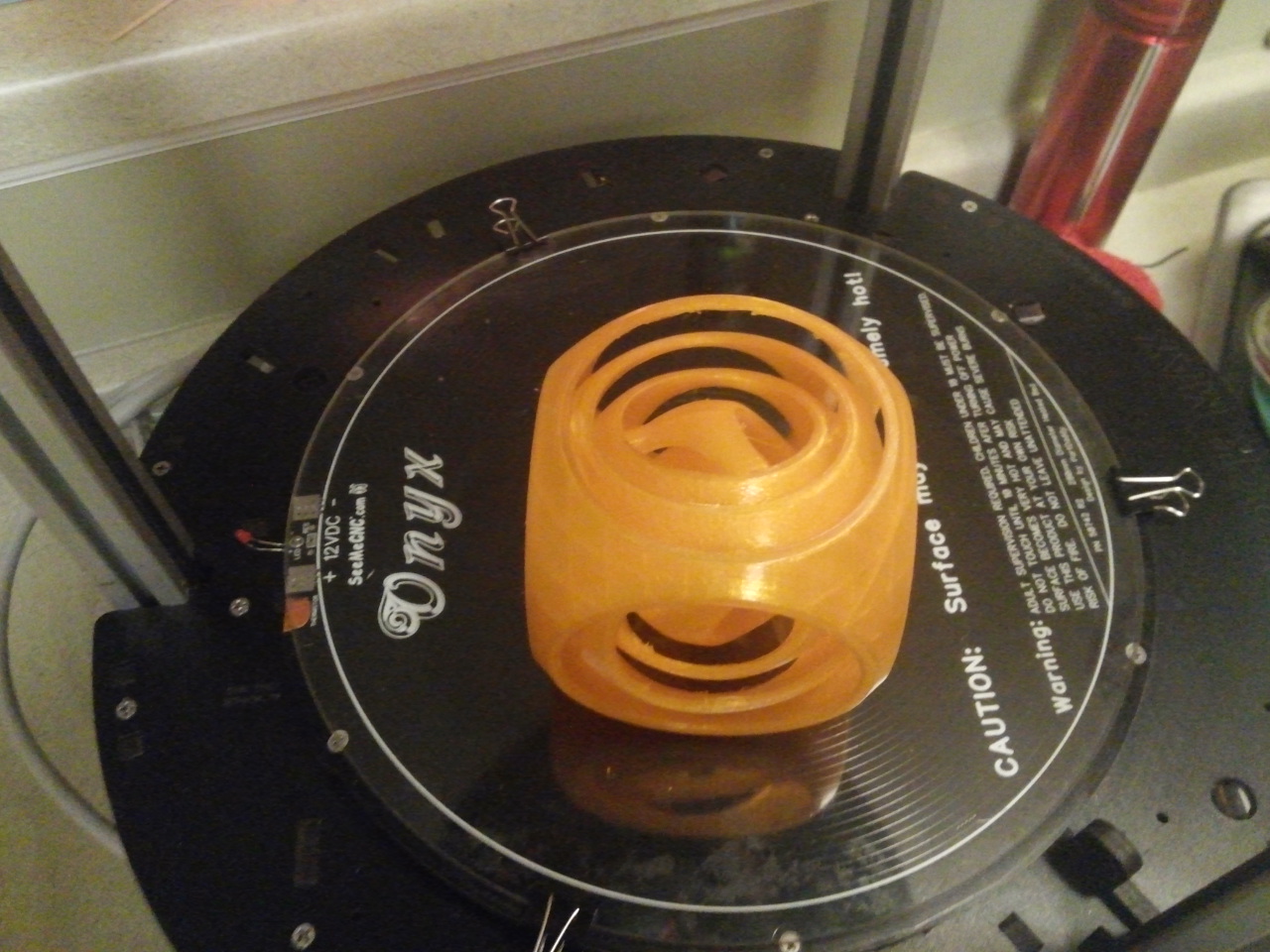

Well, i have been wanting to print this gyro cube for some time. did it the other day finally,
came out great, there is no cleanup as you see,
took 11 hours, scaled to 100mm high
.25 layers
30mm sec speed
2 loops
20% infill
PLA ( justpla.com )
205 nozzle temp
60 bed temp
& hair spray works well for me.

Very nice. Is is it ABA or PLA and what nozzle temp?
Also what did you use to keep it suck to the bed? Hair spray?

hi sorry for leaving out those details.columbia_u2 wrote:Very nice. Is is it ABA or PLA and what nozzle temp?
thanks
Keep up the good work.
PLA ( justpla.com )
205 nozzle temp
60 bed temp

User MHackney came up with the printing of PLA on regular copier or printer paper lightly adhered to the glass with spray adhesive. The PLA really sticks to the paper.Print_This wrote:hi sorry for leaving out those details.columbia_u2 wrote:Very nice. Is is it ABA or PLA and what nozzle temp?

yea read about the paper etc. nice, i have been pretty content using the hairspray seems to work well enough for me as far as holding parts down and still easy to clean up etc. have to try out that method sometime for sure.Eaglezsoar wrote:User MHackney came up with the printing of PLA on regular copier or printer paper lightly adhered to the glass with spray adhesive. The PLA really sticks to the paper.Print_This wrote:hi sorry for leaving out those details.columbia_u2 wrote:Very nice. Is is it ABA or PLA and what nozzle temp?

very nice! could you post a link for the file? there seems to many different ones out there.

hi yes sorry i should have included the link etc...Holy1 wrote:very nice! could you post a link for the file? there seems to many different ones out there.
http://www.thingiverse.com/thing:165424/#files
sitting_spheres_repaired.stl

I have never been able to make this print right on my Replicator.. but after seeing this I think I'll give it a shot on my MAX! Your print looks awesome.
