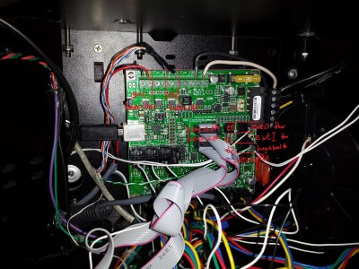

ok so attached is my rambo, ive written on it with my current setup.
on the top you see ext0 wired into heat0, on the right you have its thermistor wired into t0 on the board which is heat_0_pin in the firmware.
we think that something in your t0 is messed up on the board so we want to hook your thermistor for ext0 onto t1 which is heat_2_pin in firmware.

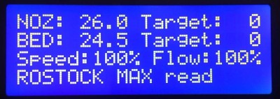

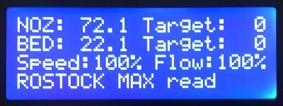

Just finished completely re-wiring the hot end itself with a new quick release. Either my moving it around or excessively taping it this time worked! Got a good temp reading and the PID auto tune is working on t0 like it should. Thanks for all the suggestions and your help!
The readings I was hoping for!
