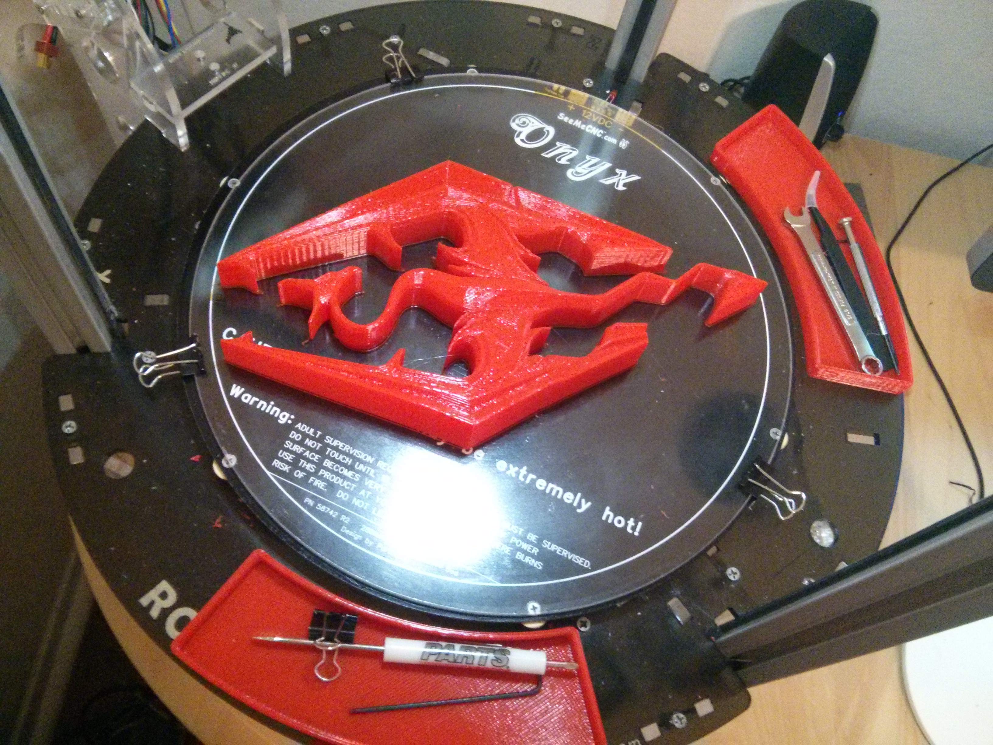

I think this will clarify the point.Eaglezsoar wrote:Does this mean that you can only print within the square area?
I printed a piece about 11" in its longest side; setting X and Y to 260mm, this is what I saw in preview. It seems that it fits really well and there is space to spare (about 1" each side).
But, when printed, this is how it was done (white circumference is the actual diameter of the Rostock Max=11", for those who are not familiar with it).:
As you can see, the piece is occupying the entire length of the bed, no space to spare!
Once I corrected the values for X and Y to get them *within* the white circle, I got the right size:
Maybe I'm being a little obsessed with this, but I just want to prevent others to get the printer go outside of the borders of the bed, as happened to me, with the undesired consequence of a GT2 belt being bitten hard by the pulleys
Cheers!

Looks like you are right at the limit of the max, pretty cool.
I see a couple of my little Rostock trays too! It would be great if you could post an "I made one " photo on thingiverse! Might help bolster my "innovative designer" image

You spotted those little helpers very well, they are handy indeed!mhackney wrote:Looks like you are right at the limit of the max, pretty cool.
cheers,
Michael
It is already properly posted in Thingiverse, thanks for the design.
