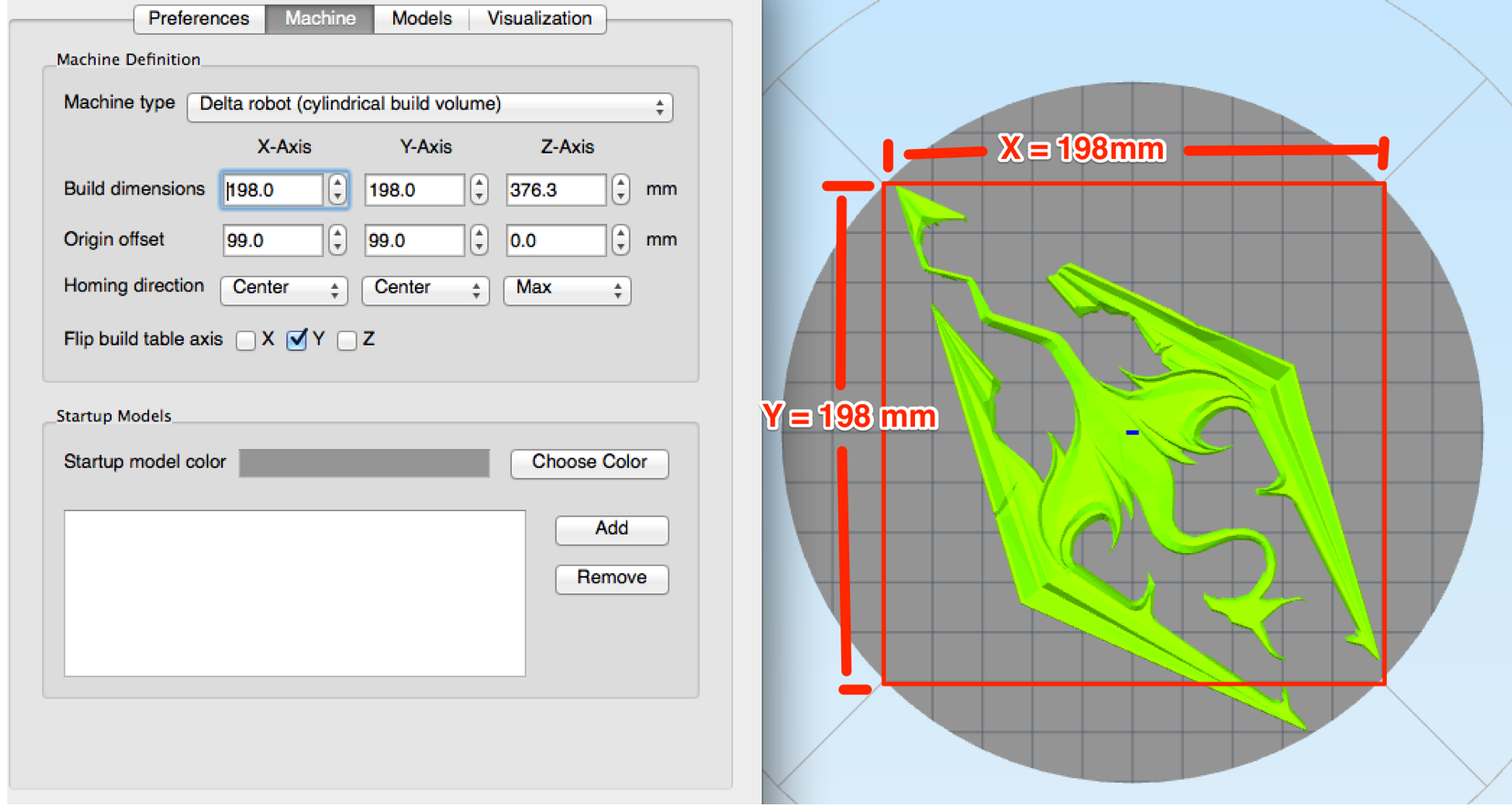

Quick question, would you mind posting a screen shot with your X, Y and Z configuration? I just cannot get it totally right, the bed looks like 110% bigger.

Well, you know, I had this very numbers and work well with small prints, but for larger pieces (+9 Inch), they get out of the print bed.
The reason is (I just figured out last nigth) because X and Y should be for a square contained within the circle of the bed, which is of a radius 280 (S3D set it to 260, but it is wrong).
This is X=Y=RSin(45°)
So, the rigth X and Y for Rostock Max should be 198.
Now I have the bed at 100% and not to 110℅ :-)

Well, here is a graphic of what I tried to explain in the previous post. I think is easier this way :-)
This is how it was BEFORE. The X and Y are set to the Radius, hence, the square bed (see the square outside the circle?) is bigger than the actual Onix heated bed.
What I found, after experimenting with X and Y in S3D, is that it is expecting those values to be of a square inside the Circle of the Printing Bed, instead of outside.
I believe this confusion is due to the Repetier to have X and Y = Radius. However, Repetier asks, as well, for the Radius and makes its own calculations for the bed

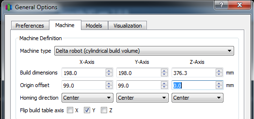

Anyway, these are the parameters I have for my Rostock Max; they seem to work fine. Before that, using X=Y=260 my large prints were caught "out of the bed". No good for the belts, they got bitten by the pulleys when the Cheapskates fell down hard!!!
Here are the parameters that *should* work with Orion. I DO NOT own an Orion, so, I hadn't tested this values, so please, use caution the first time you go to the edges of X or Y.
PS. The Z value, of course, depends on your actual height. I guess it is always the same value for Orions.

Does this mean that you can only print within the square area?
artexmg
Posts: 291
Location: Houston, TX
Re: Simplify3D ver 2.0.0
Post by artexmg »
Eaglezsoar wrote:Does this mean that you can only print within the square area?
No, not at all.
The square is just to calculate the correct value for X and Y, nothing else.
Good you asked, as it could be misleading :-)
