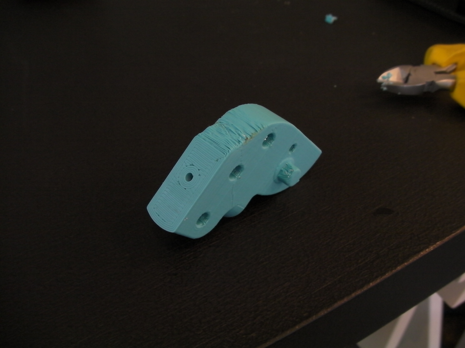

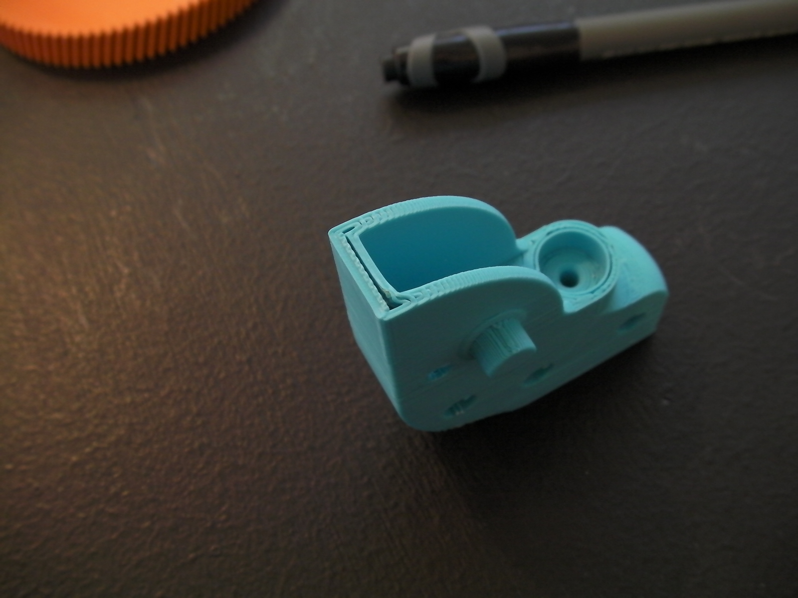

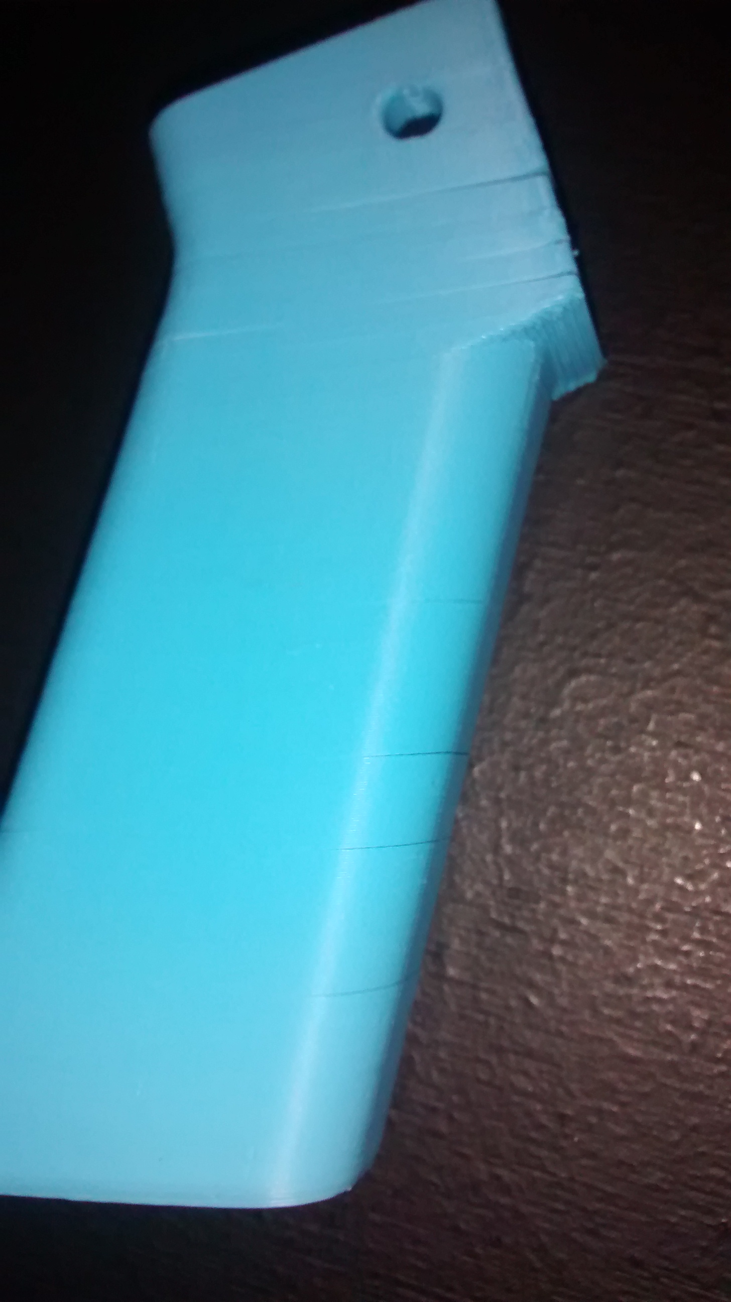

Hello, and thanks for all your replies! I'm glad to say I've printed another part at higher temps (230/110) and there were no cracks. I did get a very flat base where the part was in contact with bed and slic3r had some trouble where there were thin walls (see pics). Here are my settings:
filament: 1.75
extrusion multiplier: 0.9
Auto-cooling: disable
Infill density: 0.6
perimeters (min): 4
layer height: 0.2
first layer: 0.35
perimeters don't touch
infill problem
infill problem
no cracks!
no cracks!
rounded corner had no support, base is very flat

you might be having an infill issue because your perimter number is so high, you have it set to 4, but on those narrow parts it is trying to do 8 total (4 on each side) so it doesnt draw infill, reduce the number of walls by half and just look at the gcode. it should show you if you are going to generate a infill
