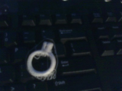

Still skewed a little but not my main concern, My quality is anything but. There is plenty of strands / out of place pieces of plastic and it just doesn't turn out right no matter what I try.My only thought Right now is to fix my y-axis bearing assemblies that are hitting the sides of the printer causing it to jerk around but it doesn't seem like that would cause all my problems. It won't print on the same line it seems. I tried printing Mhackney's wedding bands and they come out all over the place. I have linear bearings on almost everything now and my x-axis slides with no effort . The belt may be a little tight but if I loosen it, it will not move the belt properly(skips over the gear). My y-axis does need some effort to move it but still little. Any other Ideas?

The y-axis now moves with no effort either, Here's a print afte I moved the bearings. Sadly this is one of my best prints . Am I running too hot still?
Re: Quality issues
You have some obvious backlash, but your going to have to show the print from more angles, and ideally in focus, so it's clear where it's failing.
Re: Quality issues
Sorry I can't focus. Its a webcam. But I do have some backlash I just don't know how to get rid of it, All my rollers for the belts are as they should and are moving.My y-axis could be a little tighter but that isn't my entire issue

Can you send us an image of the intended model?
Have you tried printing a standard calibration object and followed the calibration steps here: http://reprap.org/wiki/Calibration ?
Unfortunately I can't see if the model is just a blob of blurry plastic, or a bunch of strands falling all over each other. Since I don't know what it's supposed to be I'm not even sure if it has the right shape.
What plastic are you using, and what are the temperatures you're using at the head and the bed? Have you verified that the temperatures are correct with another thermometer?

Kinda big update, Did the hose clamp belt mod and it helped alot, PIcs tomorrow maybe but it still has some(alot) stray pieces of plastic that looks like spaghetti is the best way to explain it, while watching my printer it looked like it would miss where it was printing(maybe have to do with the fact that the ring was curved instead of flat on its perimeter) There is also alot of spaghetti pieces at the "tip" of the ring where attachments hook on to( look on the link awhile back of what I was trying to print and you'll get the idea)
