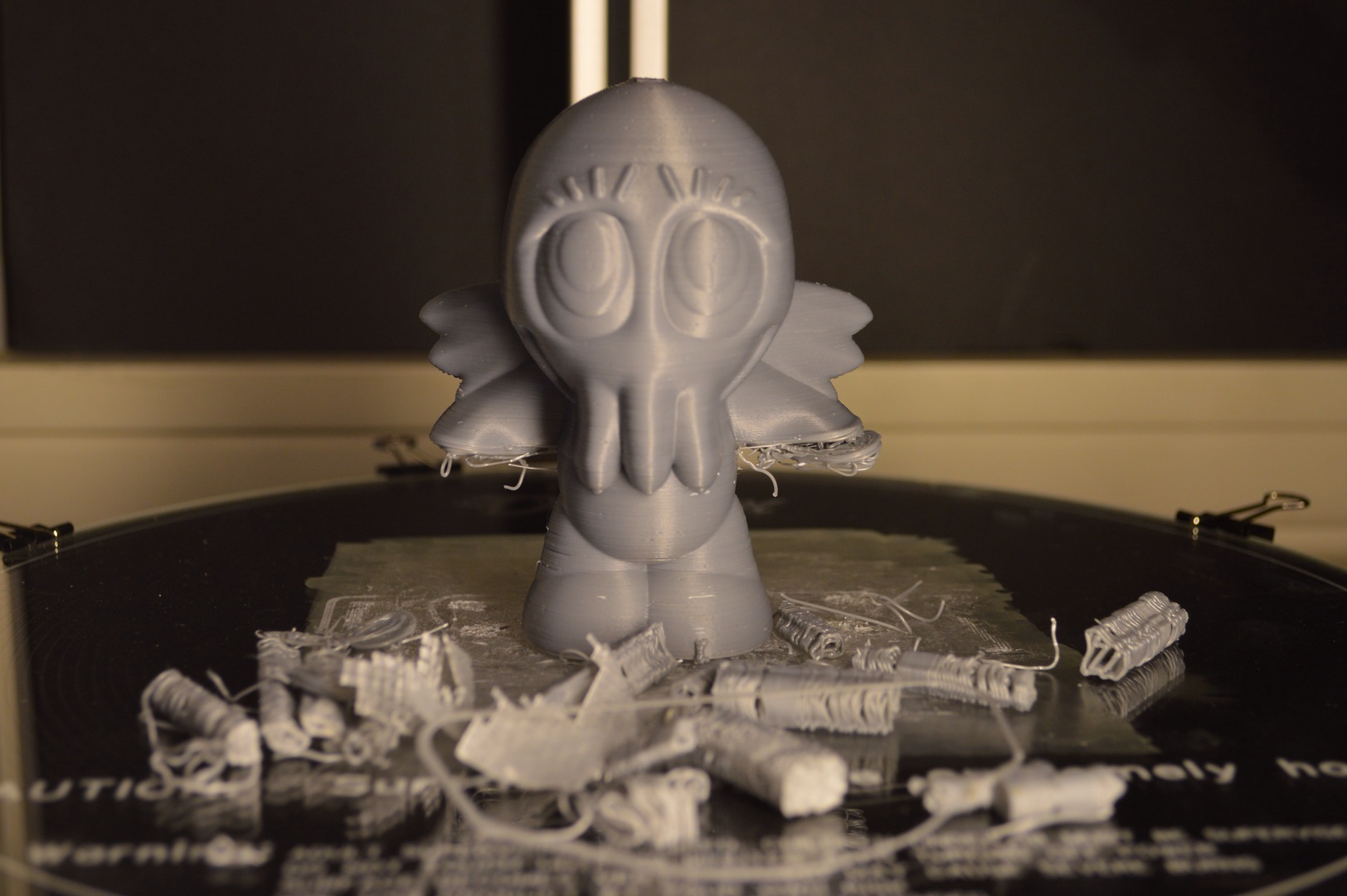

Printing a little toy figure in ABS for a friend at about 4" tall with supports for the first time. Honeycombed the infill and added supports with rafting to keep them stuck to the base.

Neat looking figurines!
