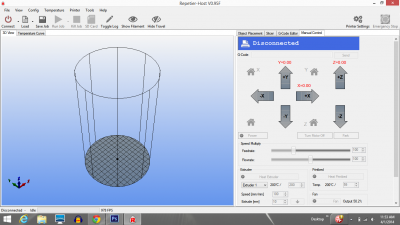

Alright, going noob on you guys here.
I'm in Slic3r, and I've opened the configure tool. Is that the right place? I've seen the term EEPROM used, but don't think I've actually messed with it knowingly.

the eeprom I am refering to is not in slic3r, it would be in the host software.. if you use repetier host, its in the menus when you are connected to the machine
when you bring up the eeprom, it will bring up a list of all the machine settings that you can change

guanu wrote:the eeprom I am refering to is not in slic3r, it would be in the host software.. if you use repetier host, its in the menus when you are connected to the machine
Guanu
Ah, would this be it?

yea, to bring up the eeprom, you would connect to the printer, and then go to config, and eeprom.. that will bring up the EEPROM settings.

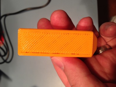

Ok, I gave your suggestions a shot, and no go, but I think I've found the problem ... just not the solution yet.
The edges of the print are not flush. There's a gap.

I'm going with the issues still in my head from another post I just did, check your belt tensions, pulley set screws, and cheapskate (like gene has in a video in a stickied thread somewhere). The variation in travel on the infill leads me to believe it is something in those areas that is the source of your problems.
