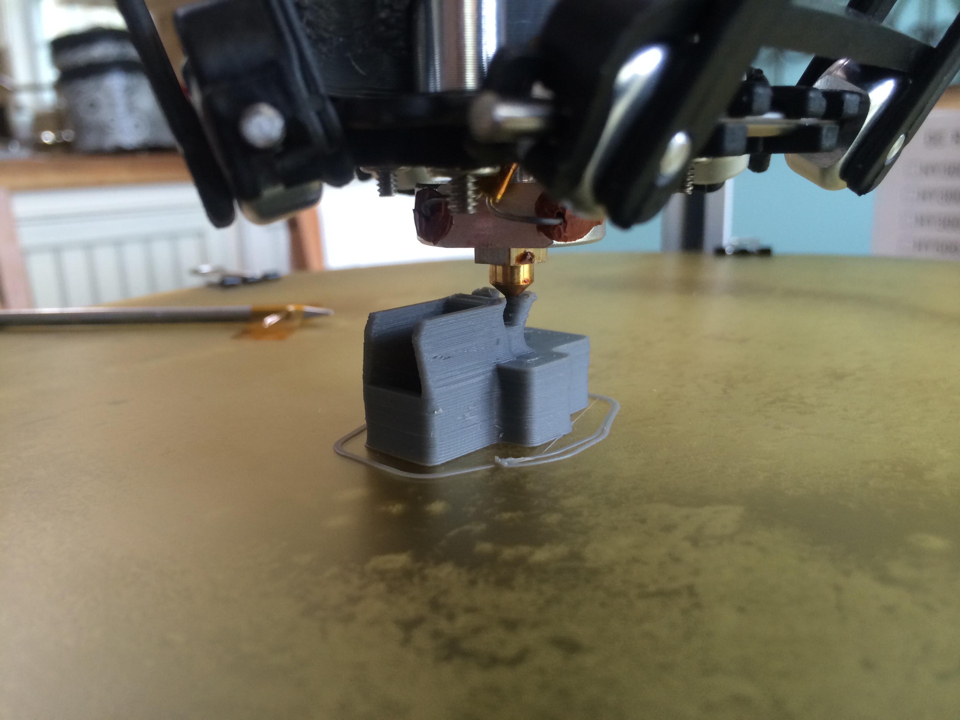

Re: Bed Heating Issues
I've attached a shot of my second ABS print at 72%...
I re-leveled my bed after applying the PEI (which I failed to do before the first print), and for now my work around for the bed heating issue is to print 60mm off center where my surface temp is reading about 82C. The bed thermister is still only reading 71.5C.
I think I will upgrade to a more robust PSU in the near future. The LED flickering seems to indicate that my current PSU is having trouble keeping up with the current demand. Has anyone else tried this with success?
Some users have converted their Onyx to run on 24v and there are many topics about this on the forum.griffinbryan wrote:I've attached a shot of my second ABS print at 72%...
Here is just one you may want to read: http://forum.seemecnc.com/viewtopic.php?f=54&t=1792
