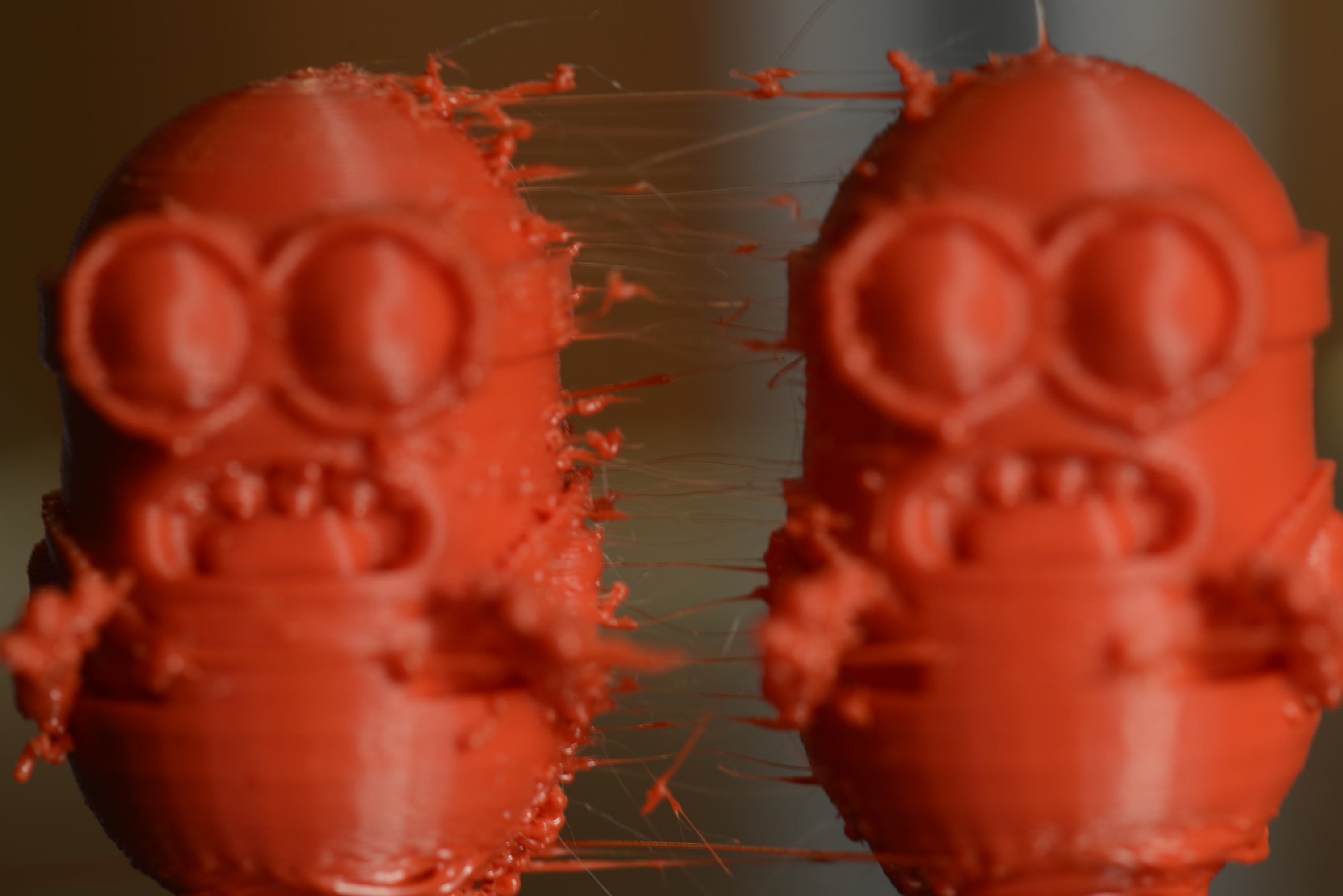

I Also am having bad stringing ( although it got worse after adding the PEEK fan and I don't know why) [yes I redid the PID calibration after PEEK Fan]
I tried to focus on the stringing in this photo, but I can see I had some motion blur. time to get a real tripod for the camera, and/or a ring flash.
Actually other than the stringing, these minions and the single minion I made with these settings have very nice finish.

For a systematic approach, you can try: http://reprap.org/wiki/Triffid_Hunter's ... tion_GuideTonkabot wrote:I Also am having bad stringing ( although it got worse after adding the PEEK fan and I don't know why) [yes I redid the PID calibration after PEEK Fan]

For over and under-extrusion, I've read that a lot of people recommend printing blocks at 100% infill. If your extruder/hotend is set incorrectly, you'll see either sparse layers or extra-goopy layers.
From your symptoms and image, I would say that you're probably setting the hotend temperature too high. Hopefully someone more experienced/knowledgeable will correct me if I'm wrong, but running the PID calibration has nothing to do w/ the true temperature of the hotend. You may have set your hotend at 230C, and it's true temperature is actually higher. Just spit-balling here, but my intuition tells me that your hotend around your heating element will get hotter after installing a PEEK fan, since any cooling effect that it has will cause the PID controller to increase its output. If the hotend is too hot, then the nozzle is more likely to ooze, and retraction will be less able to pull the filament back and prevent stringing.
Might be wrong and totally misguided, but that's my thought.
For me, I just did trial and error with a bunch of different retraction and retraction speed settings on the hollow pyramid test piece, and I found that selecting the right hotend temperature made the most positive impact on my prints.
Best of luck!
