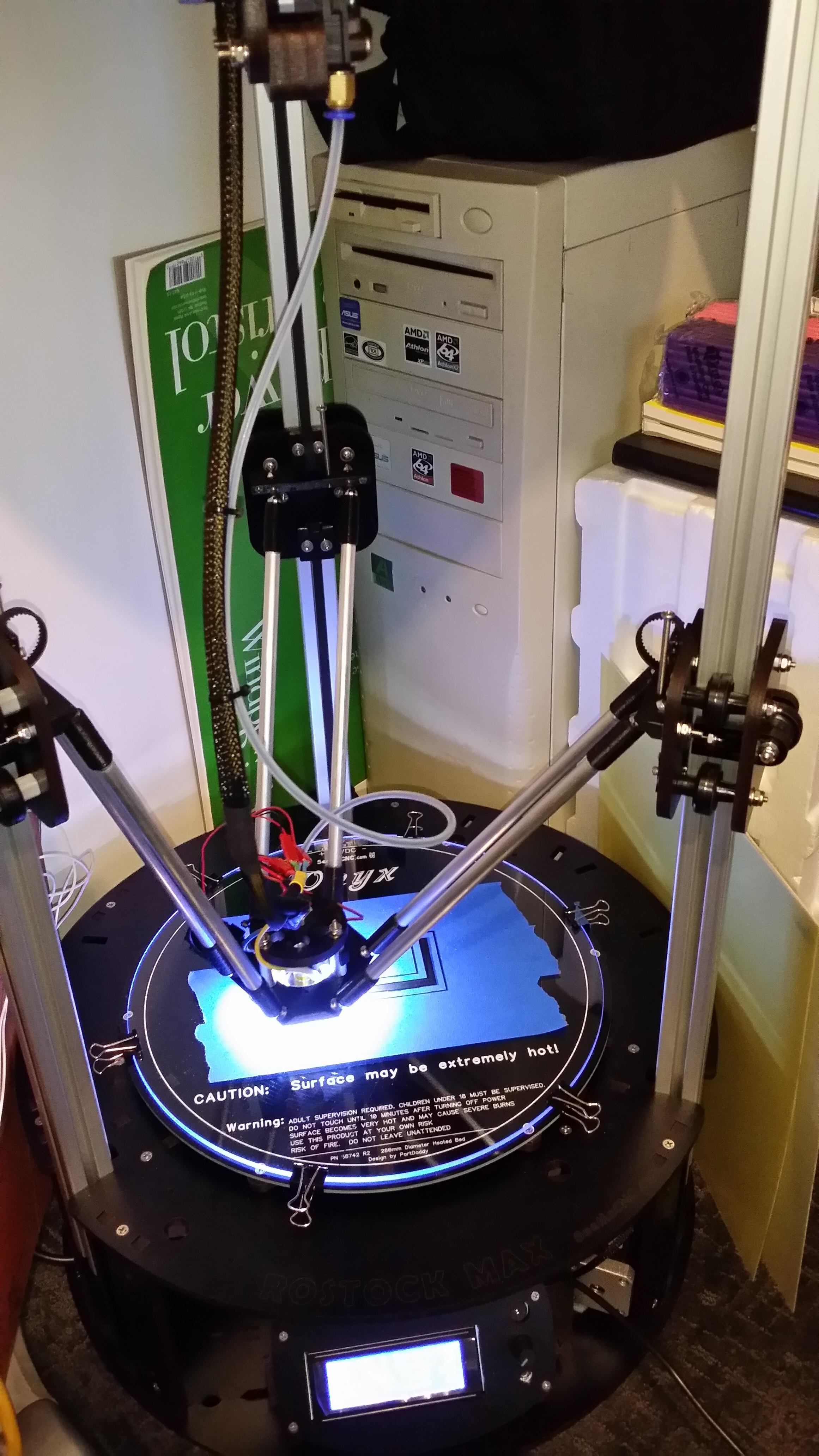

Well I took the plunge.
Removed my stock arms and assemblies... and I'm kinda glad I did. A few of the arms were very stiff. I'm surprised I wasn't seeing errors in my prints. One of the u-joints was almost seized in place, and yes, they were all lubed. Either way, it needed some TLC. I only have about 10 days of print time on the machine, so that's some pretty quick wear. With all the other people with joints seizing up though, it shouldn't be much of a surprise.
Installed the new effector... man that's nice and easy. Just snap into place and BAM! Done. I made a second effector for the E3D, but haven't assembled it yet. I'd like to make another effector with a dial indicator for easier future calibration too. Being so easy, it's hard not to!
There was quite a difference in my delta_radius with the new arms and with the upgrade, I also lost about 18mm of Z height. I have to go back and read, but I'm not sure if that's typical, but I'm guessing it must be. Changed my effector spec in the configuration.h as specified before the calibration and now I'm printing.
I'm running off a 6hr print that I had completed earlier today with everything stock so I'll be able to see how it adds up. Exact same file with settings so it should be a direct comparison. I'll throw up pictures tomorrow after work. I'm hoping to see a quality difference, but I'm a bit scared there is going to be a scaling issue. I tried taking some callipers to it with the hot end whipping around and at first glance it seems like it's printing too big. 7.3mm instead of just 7mm kind of thing. I guess I'll be able to check for sure in the a.m. though.

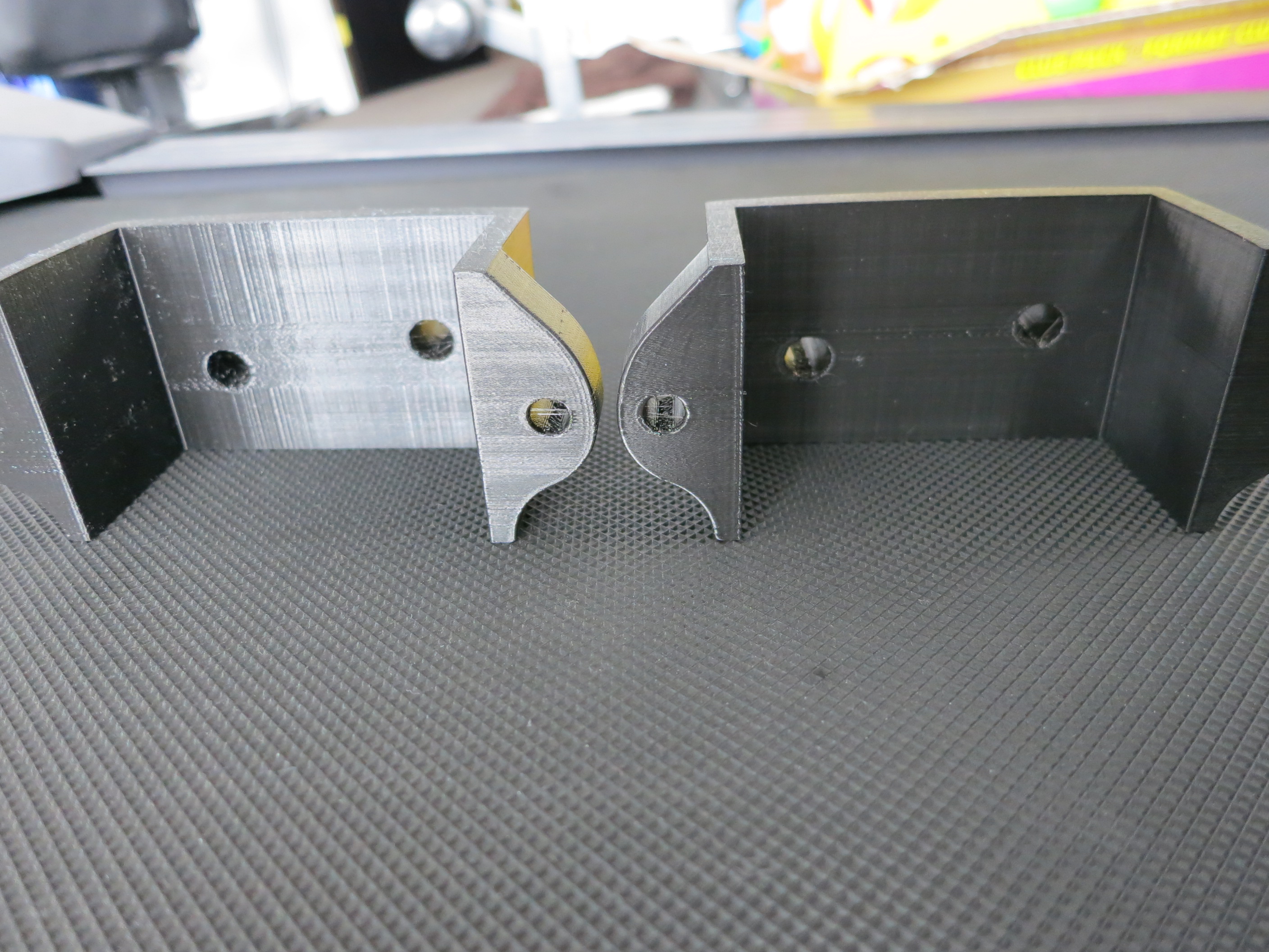

Well here are the pictures of my part result:
There are a few horizontal 'artifacts' on both of the prints, which would make me think slicer/gcode error, but they're not always in the same place. Very close though. Must have been something to do with printing speed.
I was incorrect in the assumption that parts were going to be too big. They're within .02mm of my original part (and about 0.1mm or less out from actual part design).
Flat walls are very slightly smoother with the mag arms than the stock arms. It's hardly noticeable. I guess it goes to show how well the redesigned stock arms really are. If there is one appreciable benefit to the upgrade, it's ease of assembly/disassembly and changing out hot ends, little to no maintenance and you don't have to worry about any u-joints jamming up.
In the end, I'm still quite glad I did the upgrade (especially after finding those failing u-joints). It's been on my list since the beginning and now I can tick it off.
