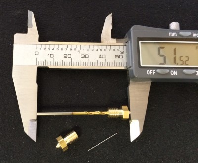

I'm very much liking the news regarding the drilling of the nozzle by mhackney. It would be nice to hear that it might allow printing at regular settings. While printing this time at high speeds was awesome and may work great on prints with a large layer surface area, small prints would stay too hot and sag without some serious cooling.

I am wondering if, as Poly said, there may be some manufacturing variation in the nozzle bore length. I'd love to know what the bore length specification is. I have unused .4mm and a .6mm nozzles and the bore length I measured was just about 1mm for each. I measured a 2mm drill bit bottomed out in the nozzle then subtracted the length of the 2mm bit to get the length of the hole. The difference was about 1mm in both cases.
Re: E3D V4 All metal hotend
Using the same measure the drill concept yesterday, I measured the orifice on the first one I had at over 3mm, but that's the older nozzle design, the newer one I checked was closer to 2mm, but it's hard to get an accurate reading without knowing the angle of the original drill, since there is no way to know if the drill is seating at the bottom on the hot end. Although it gives you a maximum. I drilled one of mine out to a 0.4mm orifice, though I'm not printing PLA right now.
MHackney's measurement solution seems like it ought to be accurate, and that seems supported by the fact that he measures the JHead at 0.5mm. If your seeing a worst case of 1mm and he's seeing 2mm's then it would seem there is variation, I'm at a loss as to how this happens. I would assume that the nozzles are made from hexagonal stock on a CNC lathe, everything would be relative to the facing operation, and unless the actual code is changing between runs or the drill's offset is not correctly set, they should be identical to within 1/10ths of a mm.

The "frozen plug" method is the most reliable measurement since it captures the actual bore length, cone leading up to it and hot zone. It's easy to do. I measured the J-Head with the frozen plug technique.

MSC, McMaster Carr and even Amazon carry the tiny metric bits.

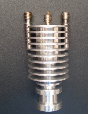

I was out of the country all weekend but whenever I found wifi, I compulsively checked this thread. I'd never heard of freezing the filament out and some of those results are fascinating. That ~2mm bore length looks way too long. It may also explain why I had good luck with the 0.6mm nozzle. Even if it still had a 2mm bore length, there would be much less resistance and possible plugging and jamming. I have also been skeptical of the thermal stability and heat transfer to the nozzle itself. I installed a much larger heater block in hopes of making the temperature more stable. Even if the heater block temp is stable, the nozzle itself may be fluctuating wildly or even at steady state but at a much lower temperature. These "dinky" nozzles have next to no thermal mass and very poor conductive heat path because they aren't seated flush to the bottom of the heater block. Compare the thermal mass of a stock Ultimaker nozzle vs an E3D hotend.
[img]http://i.imgur.com/SDSpqvUl.jpg[/img]

I got mine through Amazon http://www.amazon.com/SE-Drill-Mini-Siz ... _ac_text_yjoecnc2006 wrote:where do you get the tiny bits?

ceramichammer, your photo clearly shows how little contact surface the E3D nozzle has! The base of the nozzle itself does not snug up against the heated block by design and on top of that, there is an untreated section right above that so heat isn't able to transfer conductively until the first thread (the lowest in your photo). Then, there are only 5 threads total. That is not a lot of conductive pathway!
Because I have 3mm filament, I believe I'm at a geometric disadvantage in how much I can shorten the barrel length. Because the tip of the nozzle is tapered, my 1/8" drill bit will leave me with a much thinner cross-section and I'm more likely to blow the entire bottom out. Here's my next test with the flange of the nozzle snugged up against the heater block to promote heat transfer. I'll have to wait on my machinist friend to attempt to drill it out.mhackney wrote:ceramichammer, your photo clearly shows how little contact surface the E3D nozzle has! The base of the nozzle itself does not snug up against the heated block by design and on top of that, there is an untreated section right above that so heat isn't able to transfer conductively until the first thread (the lowest in your photo). Then, there are only 5 threads total. That is not a lot of conductive pathway!

[img]http://i.imgur.com/EEnY6bql.jpg[/img]

to get most thermal transfer to nozzle why not screw the nozzle into heater block FIRST until flat seats against block, then thread heat break in from other side until it bottoms against nozzle, then lastly screw heat break into the cooling fin body?? I have not done this yet, but am planning on assembling my E3D that way.
why leave the gap?
am I missing something here?
why leave the gap?
Because that's not how E3D says to do it - most likely to prevent breaking the heat break at the thin section. You want to tighten the nozzle agains the break, not vice versa.
That is what I did in the photograph above. I agree it sounds dumb but the E3D assembly instructions say specifically to leave a gap. http://files.e3d-online.com/Drawings/E3 ... Manual.pdfbvandiepenbos wrote:to get most thermal transfer to nozzle why not screw the nozzle into heater block FIRST until flat seats against block, then thread heat break in from other side until it bottoms against nozzle, then lastly screw heat break into the cooling fin body?? I have not done this yet, but am planning on assembling my E3D that way.
why leave the gap?
My best guess is having that gap there is confirmation that the nozzle is seating against the heat break and not accidentally the heater block. Either way it seems silly.
