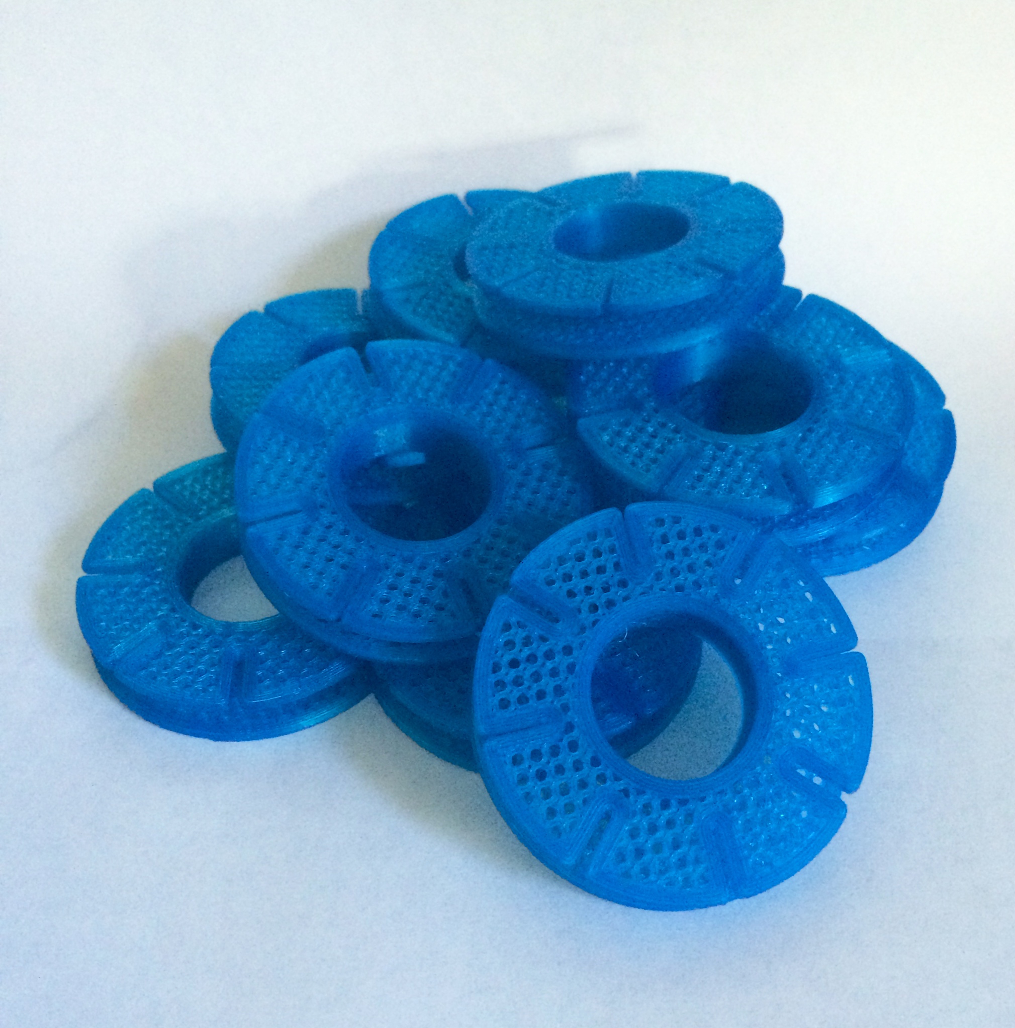

I have now printed well over 100 parts - more than 90 of them were parts that I struggled to print without some form of PLA jamming at some time - with absolutely NO PLA JAMMING. The short .5mm nozzle bore is critical I believe. Not only did these parts print perfectly, I was able to print them at reasonable PLA temperatures of 185-190°C and at speeds up to and above 60mm/s. This is the fastest speed and lowest temps I've ever been able to sustain printing with the Kraken. The same "fix" applies to the E3D hot end as they share the same nozzle and basic geometry. I have not heard back from Sanjay and Josh from my original email so I just emailed them again. I'd like to know if they have followed up on this and tried it out themselves and also what their actual bore length spec is for their .4mm nozzles.
In any case, I would really like to see if someone with a jamming problem could resolve it with a shortened nozzle bore without any of the other debuting and polishing fixes we've tried. I am willing to send a bored nozzle to someone with an E3D PLA jamming problem in exchange for them sending me their original nozzle. Or, simply rebore your nozzle yourself with my instructions published a few days ago.
I am now more confident that the long 2mm bore on the .4mm E3D nozzles has been the root of most, if not all, PLA jamming issues. So much so that I am claiming V*I*C*T*O*R*Y!

A video printing my tenkara line holders on my SeeMeCNC Rostock Max v1 at 80 mm/s on PEI at 50°C. This is the Kraken hot end, PLA at 190°C with my "shortened nozzle bore" mod to the Kraken nozzle.
[youtube]http://www.youtube.com/watch?v=29Y73qZBVdE[/youtube]
I can print all day at these speeds with the Kraken now. I'm also starting to bump up the speeds to see how high I can go. Unbelievably (at least based on my earlier experience) I have not had to bump the temp for PLA up much at all - this is 190°C and I have actually printed at this speed at 185°C but why push it!
All of the rattling you hear are my binder clips vibrating during the sinuous infill. This machine is just amazing!
Here's a pile of finished parts ready to ship:
