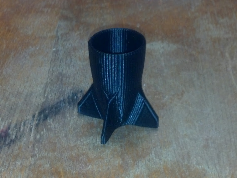

I printed a Rocket Shot Glass http://www.thingiverse.com/thing:9916
It looks corrugated because I don't have the acceleration figured out yet.
It accelerates and decelerates for each line segment that makes up the
circle of the body, and when it does, the extrusion gets wider. It also
makes the overall runtime longer, because it never gets up to full speed.
I'm running Teacup firmware on a regular arduino.

Does teacup have accel? I didnt think it did, but if it does, heck yeah, tweak on it! My accel is usually around 800-1200 for an H1. Hope that helps
Re: My first print that's not a test pattern.
Teacup has several options for acceleration.
Here's a snippet of config.h where acceleration is configured:
The Rocket Shotglass was printed using ACCELERATION_RAMPING
With the numerous short moves that make up the circle, it was never getting anywhere near full printing speed. It also looks like the extrusion rate doesn't decelerate as much as the x-y motion, causing over extrusion at the beginning and end of each move. That resulted in the corrugated look of this print.
I tried RepRap style previously, but it had some behavior that caused other problems. Specifically, "Each movement starts at the speed of the previous command", even if the previous move was a rapid, non-printing move. That makes the current move start out too fast and slow down to the desired printing speed by the time it reaches the end of the move. This was causing me grief with adhesion at the beginning of a printing move that immediately followed a rapid non-printing move.
I also tried disabling acceleration entirely, but that didn't seem right either.
Looks like I need to design a controlled experiment.
Or maybe I should dive into the code and fix the RepRap-style so it resets the acceleration appropriately after a rapid move.
