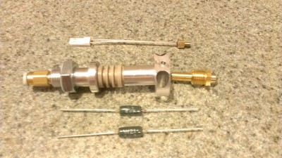

Parts for a new Hot End with new screw in thermistor and 0.35 nozzle.

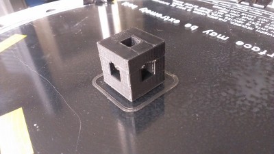

First Print in PLA, I think I like it better than ABS plastic.
Note to self don't use as much hairspray next time (I had to tap it off with a hammer)

That looks really nice for your first PLA. I don't see all the hairs and strings normally associated with PLA.joecnc2006 wrote:First Print in PLA, I think I like it better than ABS plastic.

Yea I was pleasantly surprised also, I used the stock settings in repetier-Host from the Orionpla config file.Eaglezsoar wrote:That looks really nice for your first PLA. I don't see all the hairs and strings normally associated with PLA.joecnc2006 wrote:First Print in PLA, I think I like it better than ABS plastic.
My latest print last night I just shot a quick spay of hairspray on the glass, the PLA stuck nice and when the bed cooled down the part practically popped of by itself, the bottom of the part was as smooth as a baby's bottom. not like when using the glue.

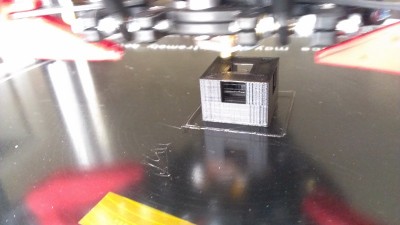

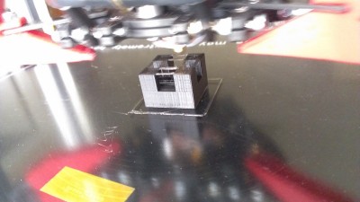

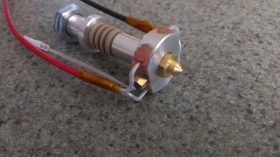

Installed a new hot end With a a 0.35mm nozzle from SeeMeCNC.
There is a significant improvement in sharpness and now the bridging works as you can see from a picture with a thin layer across open space.
On my final layers I need to get the line spacing a little closer. Have to figure that out in CURA.
Used Cura 14.03 to generate G-Code and print with Repetier-Host.
PLA with no strings at all.

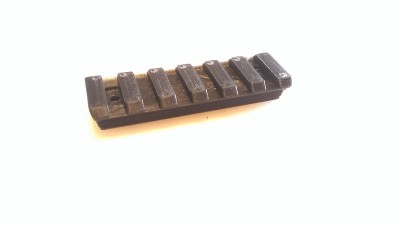

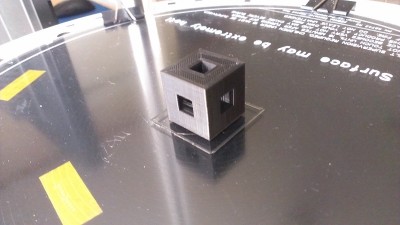

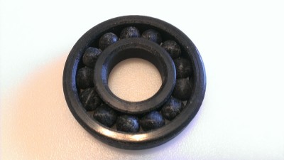

Testing what the printer can do, These came out good and work well after a few cycles.
70mm wide
70mm wide
Joe
