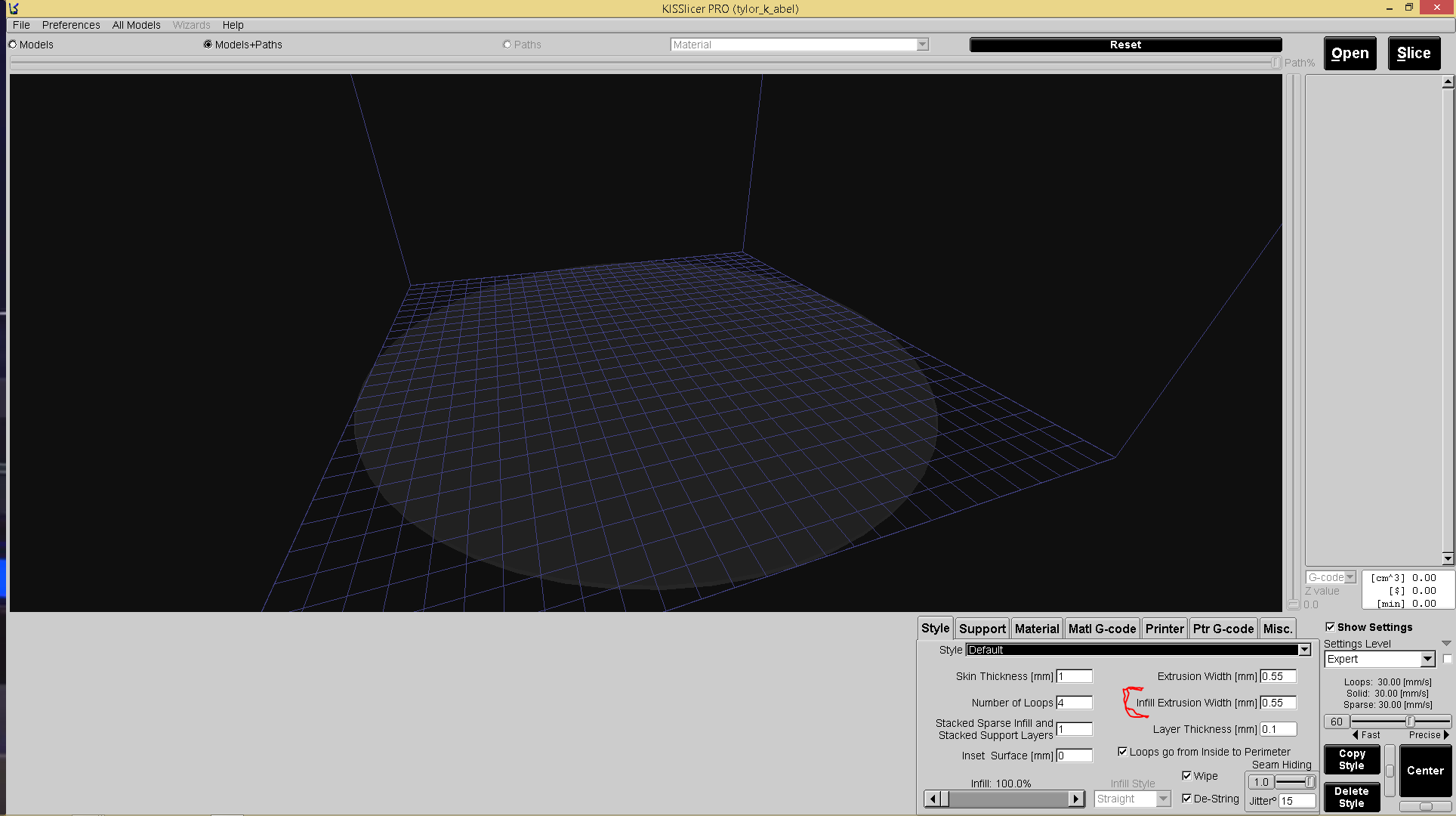

i use kiss but you should look for a setting that control infill extrusion width. or try slicing in a different program

Kisslicer on the other hand has never had any infill gap of any sort... as well as the other bonuses that Kiss offers. I just don't think slic3r handles filament flow very well at all...

One other thing you could try is setting the extrusion width for top/bottom layers to a different value - it's on that advanced settings screen. Telling the extruder the width is narrower should force it to lay down more plastic.
