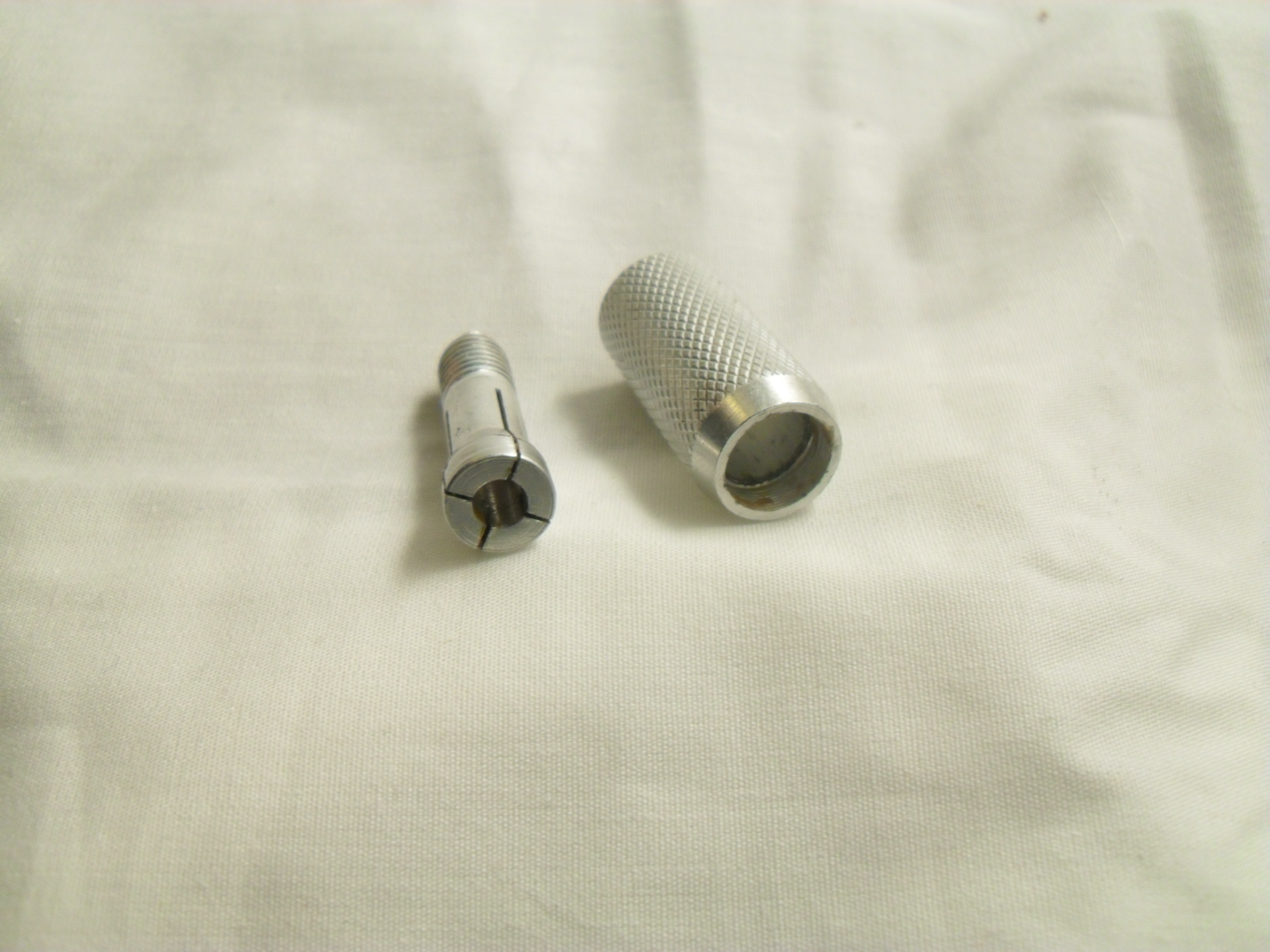

I have no idea what the coupling/fastening system is called but I have long thought that the type of connection used on on large X-acto knife handles would make a good cold end PTC substitute. Pic included since I'm bad at explaining things.

It's called a collet and I think you're on to a good idea. I still think threading on the tube itself with matching fittings is the answer. If you look at this thread http://forum.seemecnc.com/viewtopic.php ... oil#p29413 it is discussed. Maybe a hybrid of a collet with internal threads? :idea:
