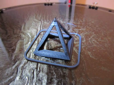

This is too much fun. Do I really have to go to work tomorrow :)
Big turd on top of pyramid, extrude temp to hot ??
Re: Rostock Max V1 finally printing
wavetech wrote:This is too much fun. Do I really have to go to work tomorrow :)
Most likely to hot for such a small area, is it PLA? Do you have your layer fan on?

ABS no fan, fan not working at moment have to setup/troubleshoot.

When you get to things like the top of the pyramid, it gets kind of soft because it doesn't give the area time to cool. What you've got there is pretty typical. Nice first prints though!
