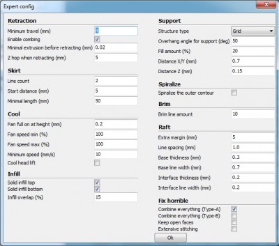

I used to get the same thing using Slic3r. I ended up going to Cura and haven't looked back.
This was the result I would get with slic3r. Much that same as what you're getting. You can see through near the top like yours and this piece is about 5mm thick. This was printed on painters tape too.
Now this is the kind of bottom surface I'm getting:
These are the settings I have in my expert window for Cura. The overhang angle is pretty steep, but the infill overlap and solid fill top and bottom are likely the money makers. Try making sure they're on.
Since you've got the exact same thing going on with your prints that I did, I'm guessing it's not mechanical.
Re: Prints coming out terribly
Ah, that is a big difference! Thank you, I'll give those settings a try and see if it fixes things! Can I ask what you have for your Shell Thickness and Fill Bottom / Top Thickness in Basic, and your Initial Layer Thickness in Advanced?
