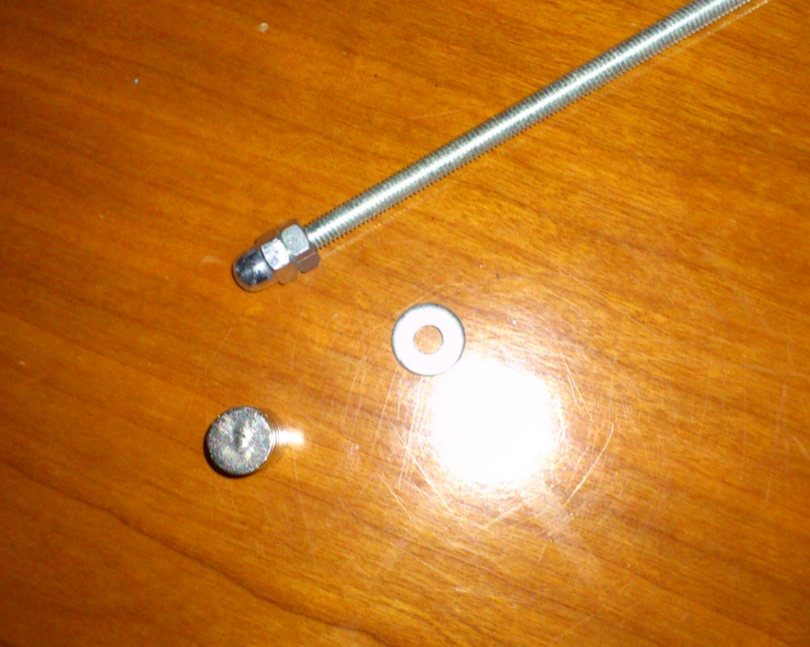

Hi guys,
what do you thing of this, almost free, solution?

I can't tell what exactly is going on in that picture, but it looks like all metal on metal contact.
The threaded rod might work great for rigidity, but it probably weighs more than other types of arms. I used brass tubes on mine.
I don't know how the magnets will work with steel around them. Steel isn't very permeable for magnetism. Also, steel rubbing on steel might have more friction and more wear than you want.
