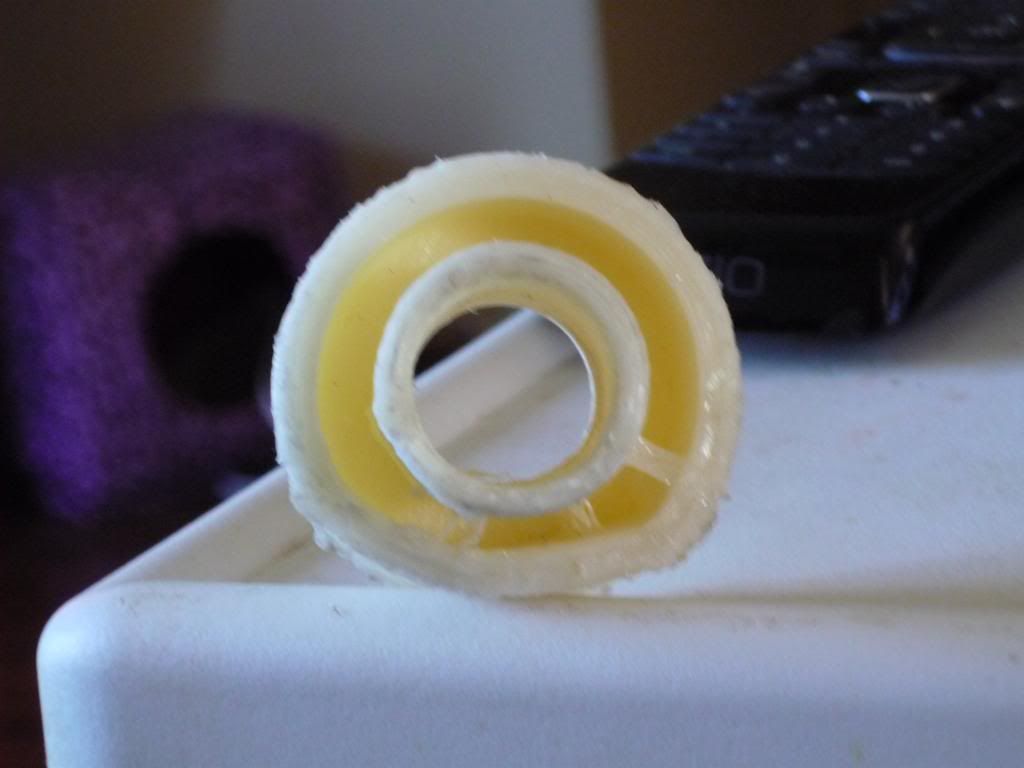

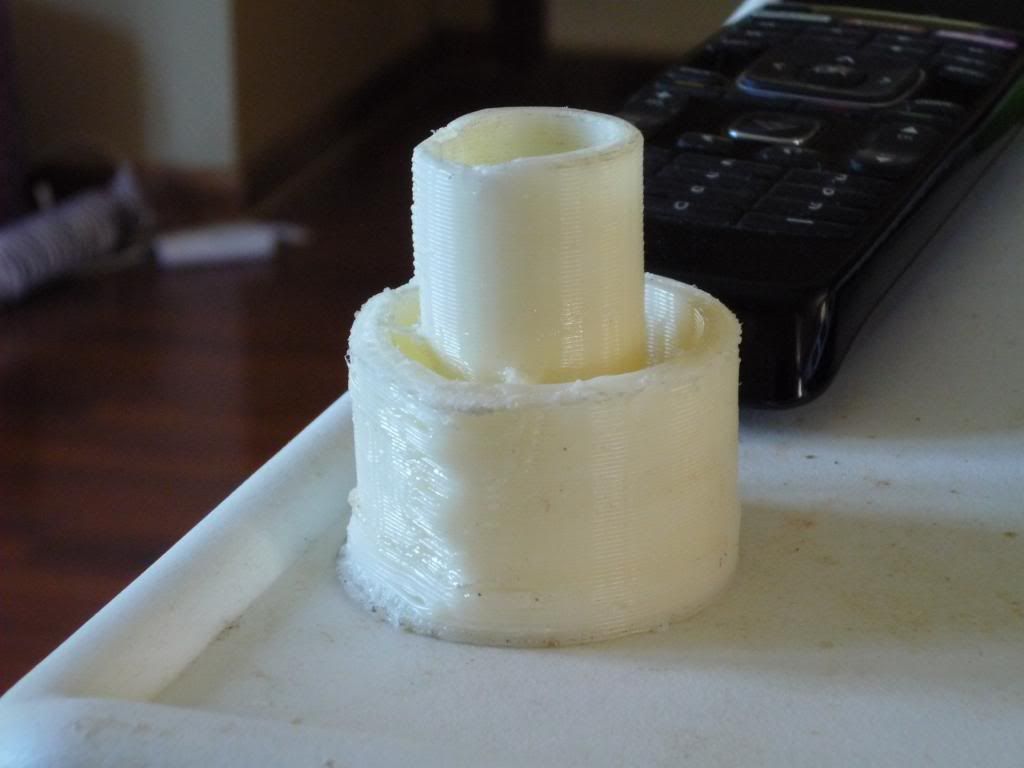

I have a kind of weird problem on my Rostock Max prints. I have zero retraction on the settings. Seems like I get weird flat spots on one side of all of my round prints. The printer seems to be programmatically following this same out line in some respects because my printer has started to consistently follow this pattern when there is either infill or an interior feature to print. When it's nothing but round stuff to print, it seems to immediately start printing round circles again. I did get a kind of weird bulge along one spot going up the circle, but it printed that circle correctly otherwise. the hollow inner side of the tube doesn't show the bulge that was there because I used a grinder to remove it.

The fact that it doesn't mess up when not printing interior features or infill indicates to me that this isn't necessarily a mechanical issue. The outsides are blobby due to lack of retraction, but otherwise the prints look more or less OK.

I'd say you are printing to hot but the that's probably not the issue with the flatspot.
My first guess would be mechanical.

I probably need to add a little more information here. This flattening artifact is facing away from the Z axis (or facing between the X and Y axis). Odds of the X and Y axis having difficulty moving up at exactly the same time in the same place over and over again like this are kind of low IMHO, so that leaves the Z axis. The problem is, the Z axis doesn't want to move downward with gravity? That also doesn't make sense to me. I tried loosening up the X axis in case it was too tight, but that only seemed to made the flattening more consistent than before (which could also be a function of time as well...)

Found the problem I think. Moved my various axis around with the machine off and notice that the Z axis had a slight give and then thunk that indicated that the pulley was slipping and then catching after a bit of movement. I had previously checked this and found no perceptible slippage, but that changed during my last two prints as it worked itself loose. Learning as I go...
