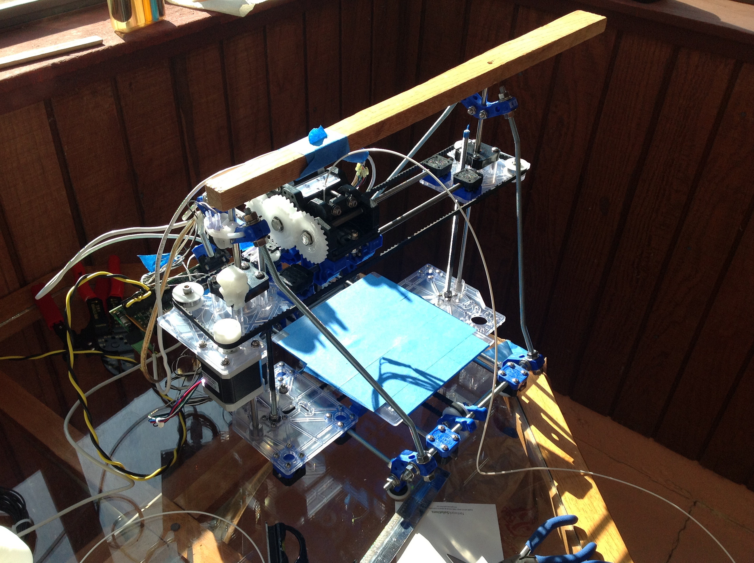

Here are some pictures. sorry about the lighting and the background clutter. All images are uncropped as they came out of my iPad, so click to zoom in on any details.
Overview
Overview
Overall view. Note the elegant crossbar at the top, lovingly hand-crafted by drilling a couple of 1/4" holes into a stick I had lying around. Measure the distance between the two smooth shafts at the bottom of the machine and make the holes the same distance apart at the the top. This is necessary because the X-axis drive belt pulls together the two Z-platforms, and the clamps that hold the Z smooth rods don't clamp.
Keep the crossbar in place as you loosen, adjust and retighten the nuts on the four threaded diagonals so that the system is stress-free when at rest.
