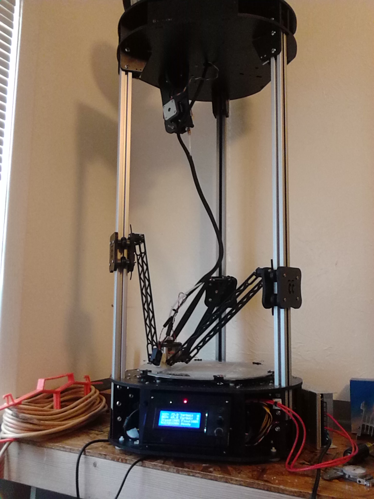

I am seeing this issue almost verbatim. I can print an object that is 4" x 4.5", but when I try to print an 8" x 4.5" object I get all sorts of kickback to the extruder feed. Basically I cannot print larger objects that take up more of the bed. There are no restrictions whatsoever when printing a smaller object that stays toward the center of the bed. I suspect this is related to the bowden tube somehow, but I cannot for the life of me figure out what. The extruder feed matches what it is supposed to be, the filament diameter is correct. All I can think is temperature on the outer edge of the machine? I don't see the thermistor values dropping when it goes to the outer edge.
Should I try to measure the filament tip ID? But why would this only do this on larger footprint prints? I can print my 4"x4.5" object just fine. That print takes 5 hours, and has no extruder feed skipping at all.

When you reach the outside of the print area, is your bowden tube getting stretched straight? Maybe you need to increase the length a few inches. If the tube is being pulled in the PTC connectors, it could be pinching the filament slightly, which in combination with a high backpressure in your nozzle could be enough to make the extruder skip. If you can, post a pic of the printer with the nozzle in the center of the build surface, and another with it to the edge.

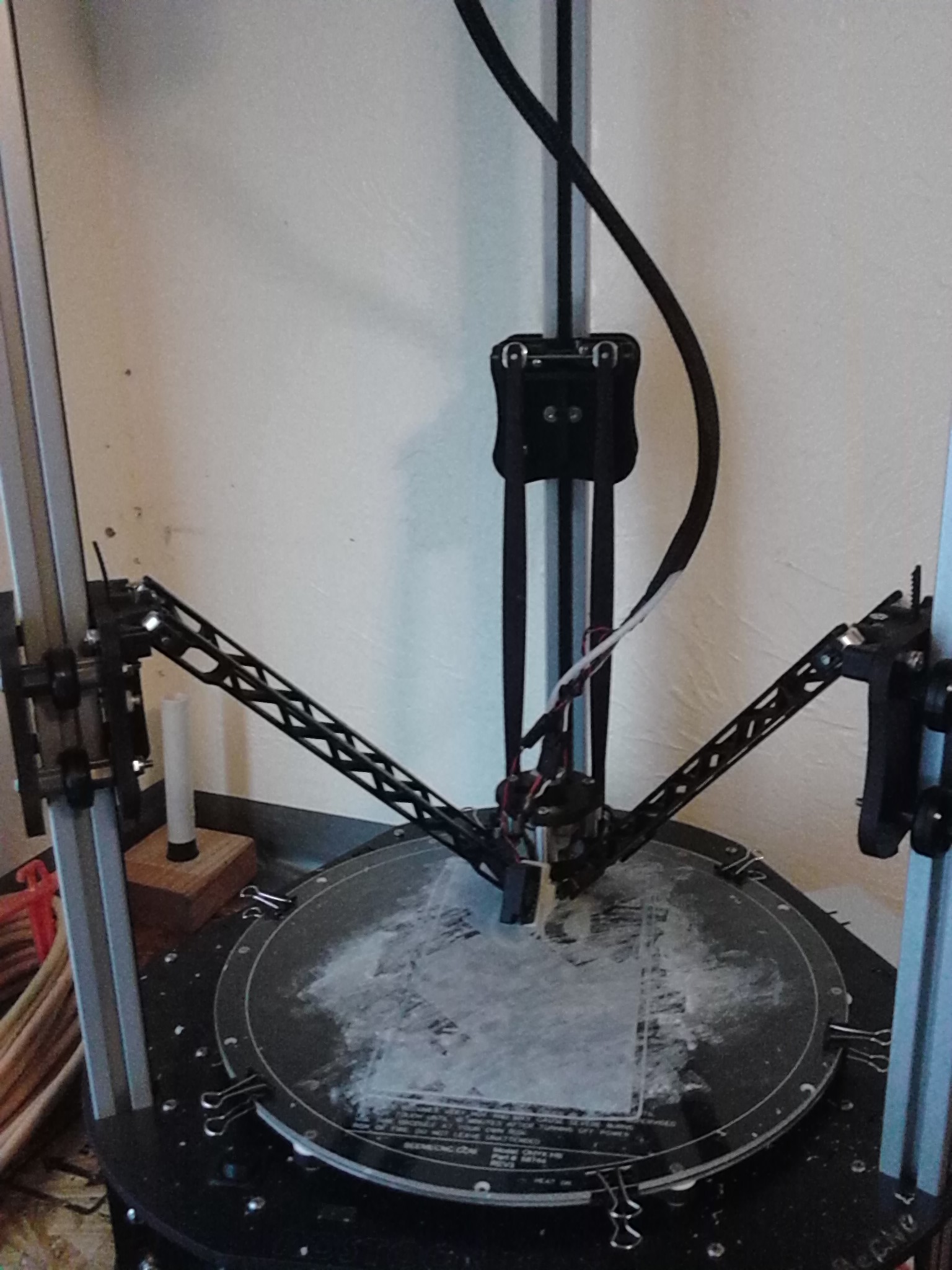

Okay, here are the extension pictures:
Center
Center
Back
Back
Right Front
Right Front
Left Front
Left Front
Front Center
Front Center
The tube does not look like it is too tight in any of those positions. At least to me it does not.

yah, there looks to be plenty of slack. Just an idea. Have you tried printing a test cube positioned near the edge? I wonder if one side tends to fail more often than the others.
