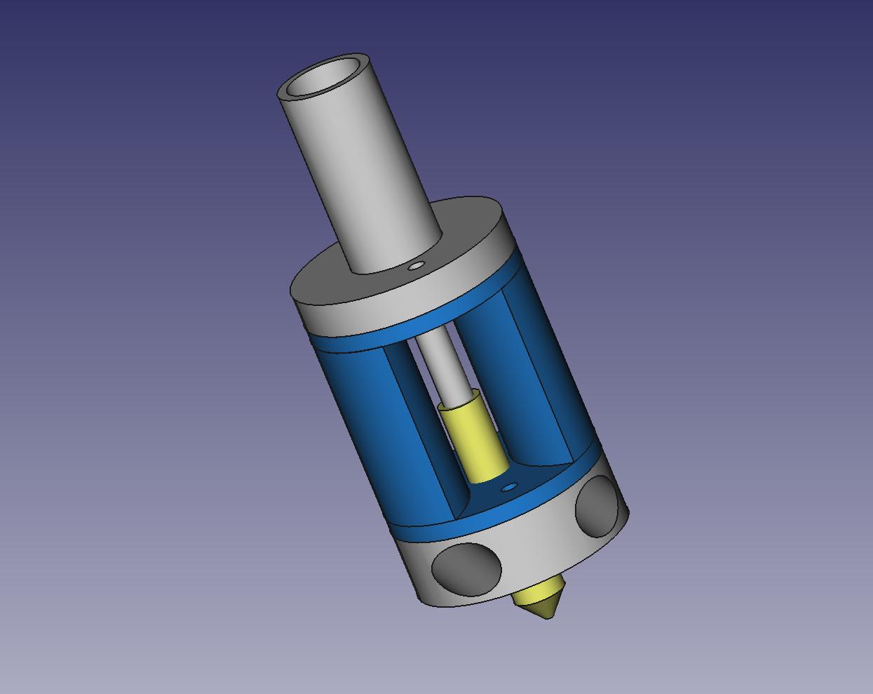

Re: PEEK Tube.
I'm actually working on design where the PEEK part is ceramic, but it doesn't directly replace the current PEEK piece. It requires 2(or 3) screws to squeeze the ceramic piece in place. You still have the PEEK fan, but it pulls air throw a hollow section of the ceramic to cool the PETF tube in the middle.
I want to get printing ninja flex so I can make a reusable mold to cast this piece, just because it's soft and will release easier.. Print the part in Ninja flex, cast in plaster, let dry, and then cast the ceramic in the plaster. Then fire... It's a lot of steps. Then you will probably have to finish the top and bottom pieces to make sure they are flat, and parallel. Or at least parallel, a thick gasket could make up the difference in some flatness.
Ceramic is an option, but refectory cement is another, and you don't have to fire it. It sounds heavy, but there are light weight versions, and you might be able to add micro balloons to help with insulation, and weight.
Another option that I'm looking at is just using a dense plaster, sometimes call mold plaster. USG has a formula for casting metal parts, that can handle 1200C. But I have no idea how well it will work in a hotend. Worried about the vibrations from the steppers, and any dusting of plaster getting on the parts.
Like are pete said, project #397

Re: PEEK Tube.
I was thinking something like this.
This would be a drop in replacement. The problem is the top doesn't have a wide enough brim to drill holes in to put screws. But you could put a washer there and drill holes in that. I have a old stock hot end that the peek melted a bit on. So I was looking to mod it.
The air channel is just a mock up to give an idea of the concept. It would need to get modeled to match a fan, and fan shroud.
Re: PEEK Tube.
I just realized I could probably 3d print that top piece... if I keep a fan on for the middle I'm sure it would work.
