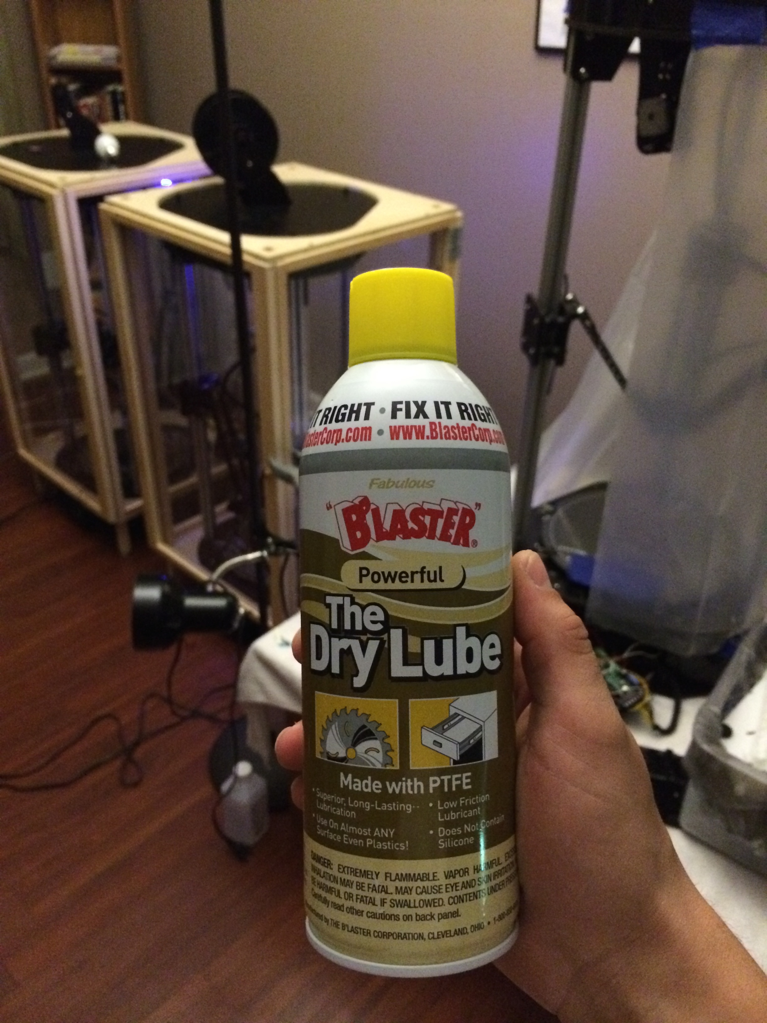

I had this issue. I fixed it with some Teflon DRY powder spray (PTFE lubricant spray). I bought the PTFE Blaster from Home depot for ~$4.50 and it did the trick! Did it for all 6 axles. I just took the axles and U joints outside and put them on some old newspaper. Sprayed them all and let them dry and then reassembled them on the printer. This worked very well and was a suggested method by SEEME. I think it was Guanu in a post on the forum that suggested PTFE dry lube.
