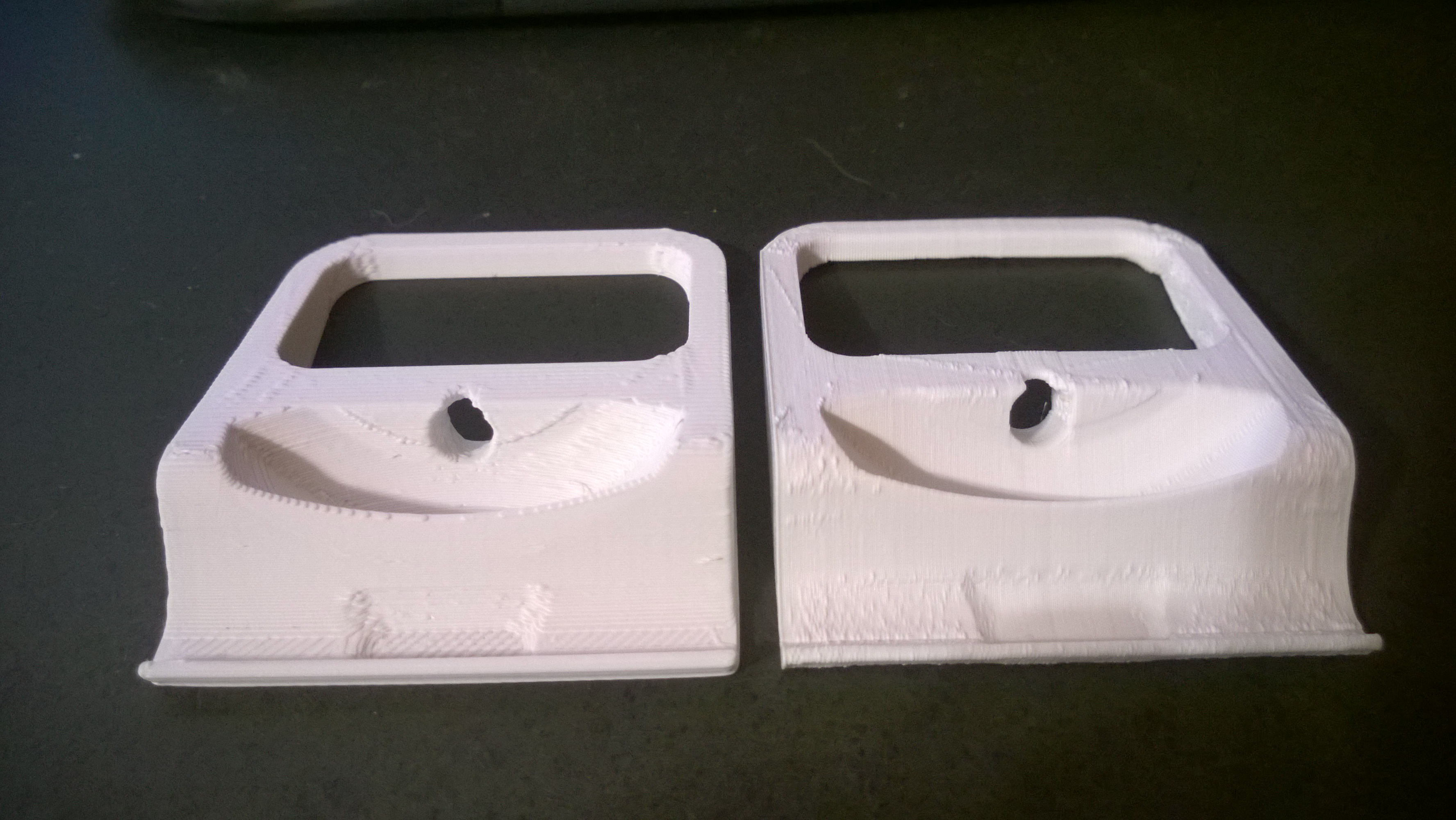

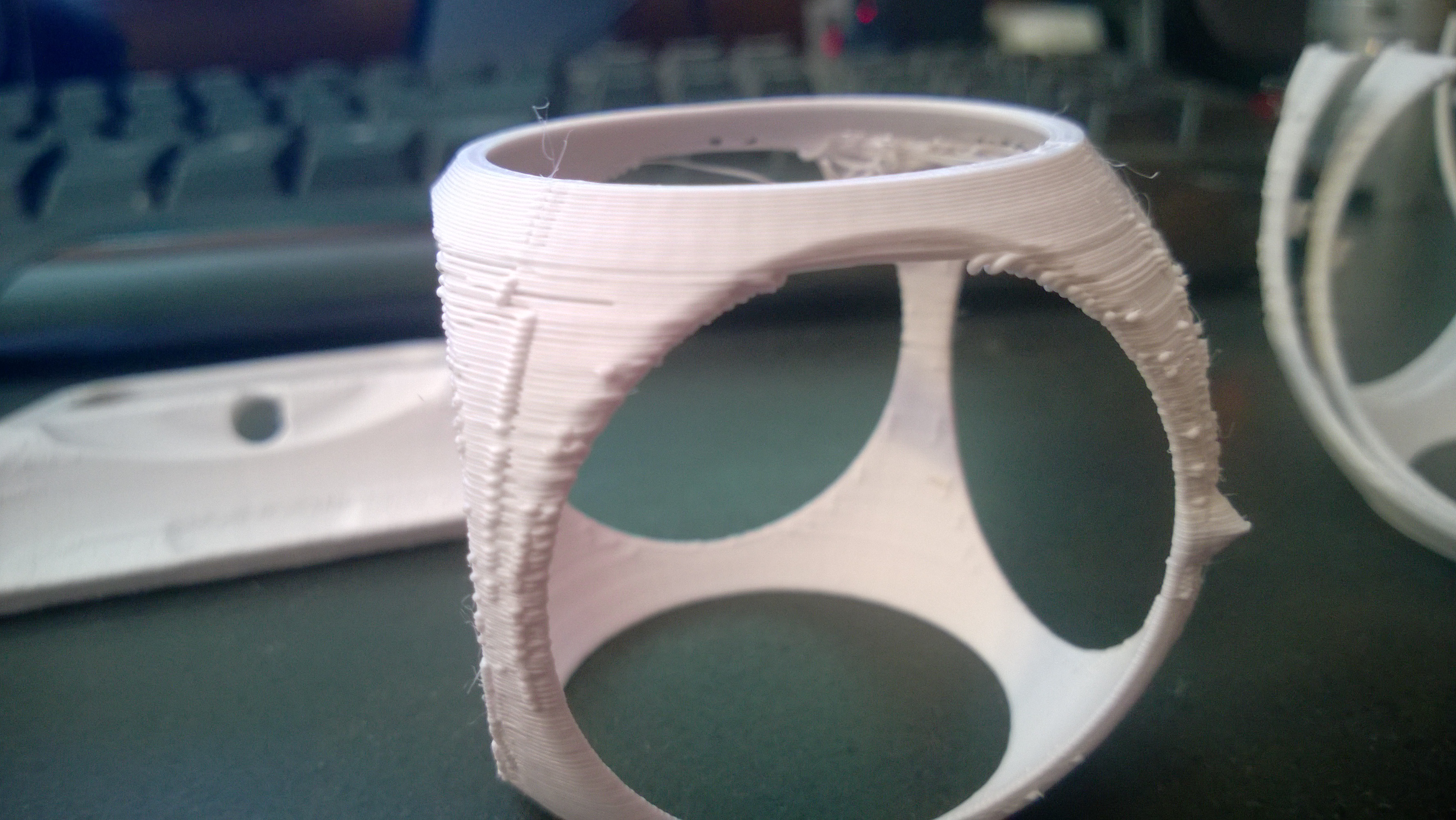

I have had my Rostock working for a few days now and have been using Cura recently since I have heard good things and it appeared to be much faster for certain prints I wanted to do. However I have had trouble with strange bumps on curved surfaces, and some flat surfaces as well. I am thinking it is related to how Cura handles the infil and inner lines, since it seems to be printing them much too fast in the thinner areas, causing serious harmonic oscillations on the printer. I noticed this first on the GyroCube which came out looking terrible and failed halfway (the hot end nicked the print and snapped it off over a few cycles) the fact that the Gyro was the worst looking one hits towards it being harmonic, since it got worse the taller it got, where the part could move more. I am not sure if anyone has had these issues with Cura, or knows how to make it print those areas slower or something (it just goes crazy in there).

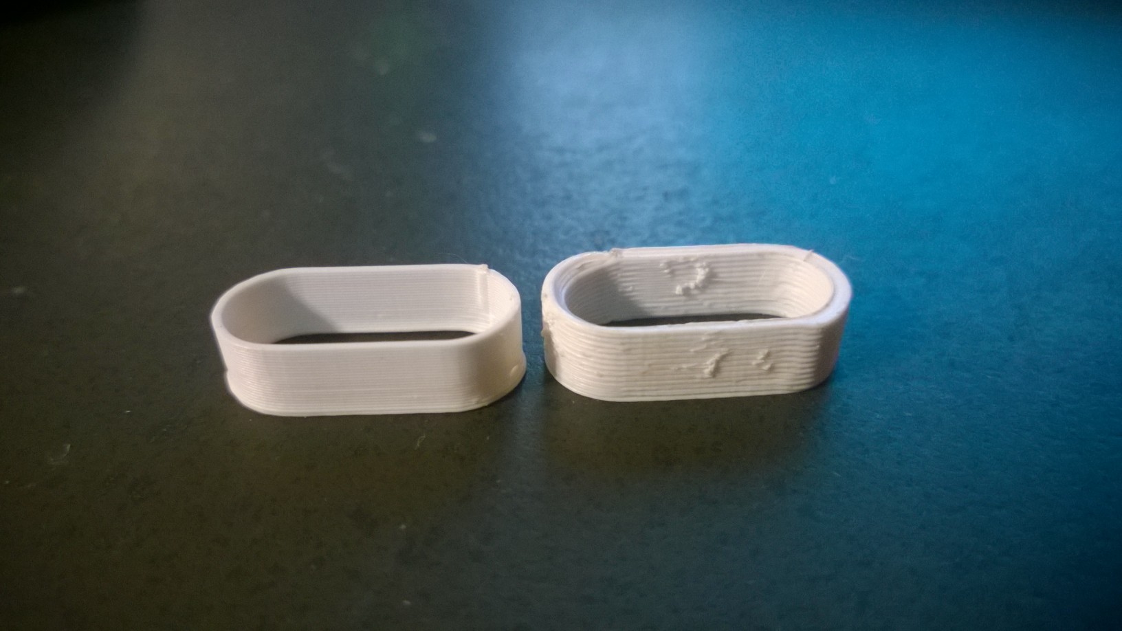

I stuck my hand in there during some printing today and the Rambo fan was working and it was quite cool in there. The Gyro ball print was at night so it was cool then as well. From what I was reading today the over extrusion thing seems like a Cura issue at times. It could be overextruding if Cura is trying to print to something my wall thickness didn't allow, I had my shell thickness set to 1.5mm and it is possible that the object wasn't thick enough to account for the two sides of the shell. I printed out a small thin walled straight slot shaped object and when printed with Cura the surfaces were extremely rough, and with Slic3r they were clean and smooth.
Left: Slic3r
Right: Cura
Other than being different slicers both were the same settings (as far as I was aware) except for the shell thickness which is handled differently using Cura compared to slic3r.

I adjusted the Cura settings to have the Wall thickness of 0.9mm and that mostly fixed the thick wavy walls, however there are still some small dots on it.
