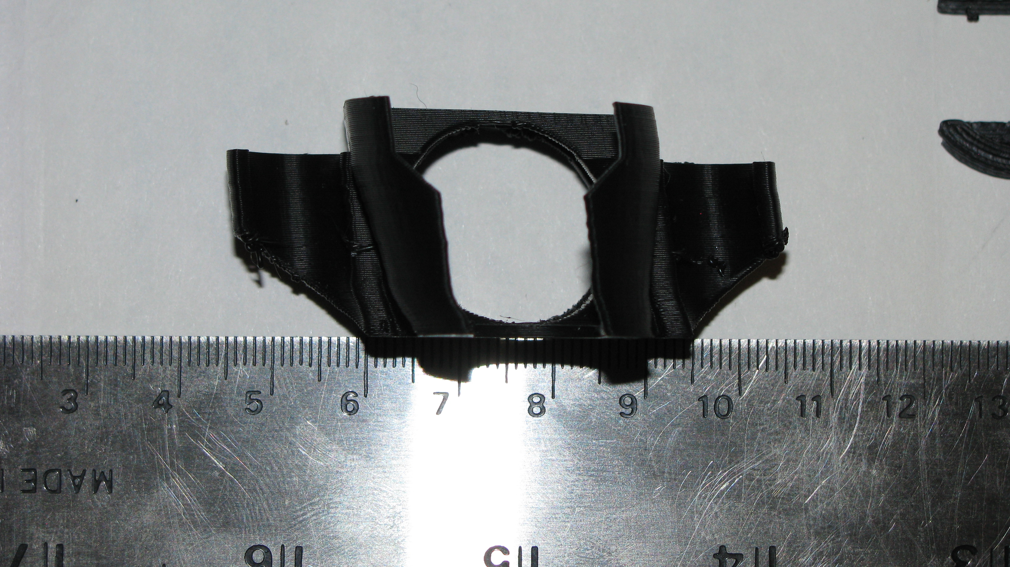

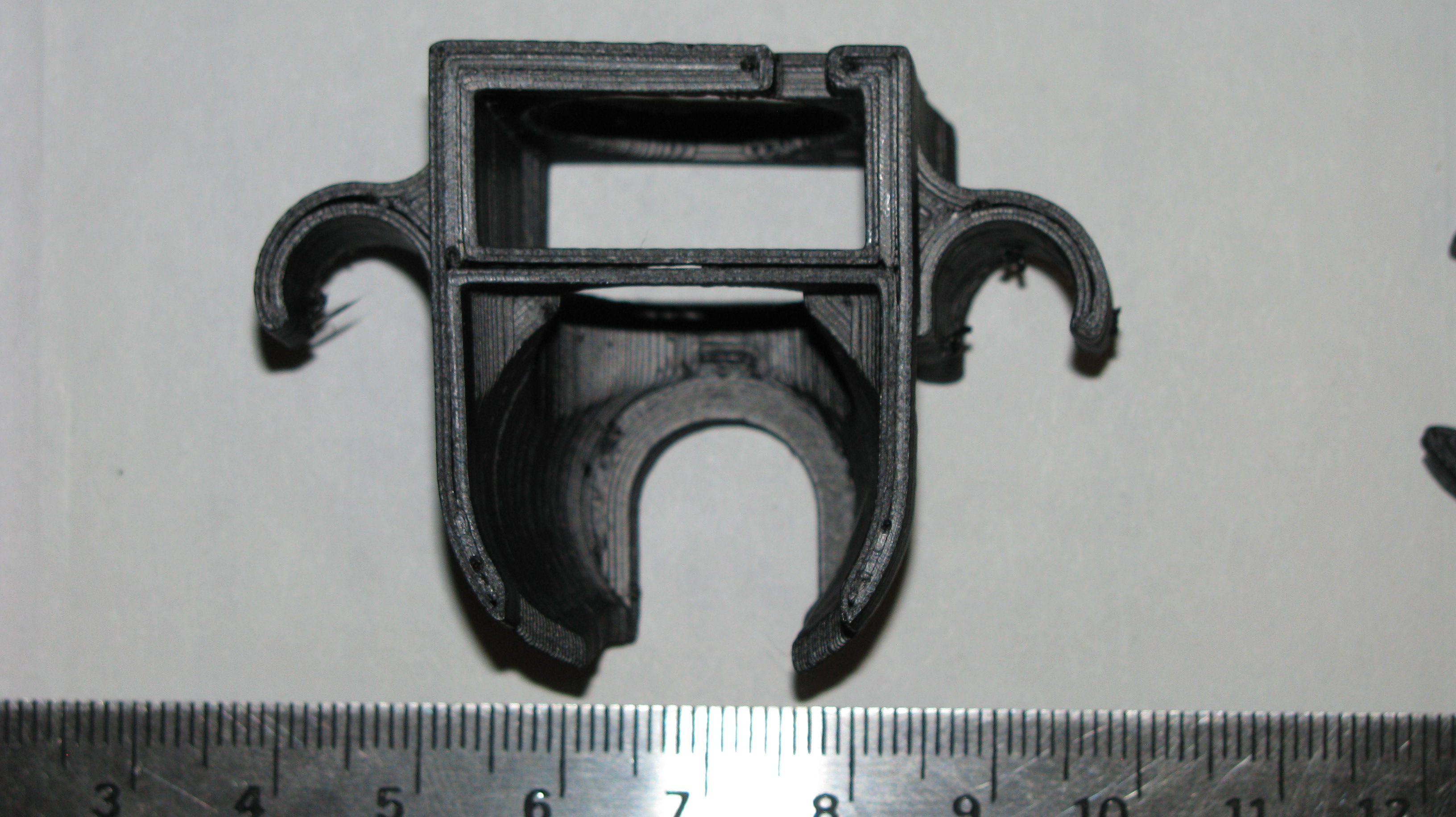

All right, I need help. When I get the bed level I've had to add long set screws in order to do so. Then when printing the layers are all level but as it print they shift away from the Y tower. I've checked the skates, belt tension and the stepper mount screws also checked the wiring for any cross interference. When the set screws are all about even when I lower the head it swings away almost an inch from center. Nothing has fixed it. What else can be done or looked at to fix this?

I am a little confused as to your leveling of the bed. Where did you put long set screws? Are you referring to the end-stop screws at the top? Do you have an example print you could show us?

All of the mechanics look good, the screws were added to the end stops. I've leveled @temp as per instructions and the scripts are all correct. I added the longer set screws because the Y tower calibration was going into the bed and I had to raise it. Y tower end stop is about 1/2 inch different from the X and Z for me to get level with the bed. When printed the Z axis layers are all even, X and Y axis are off.
