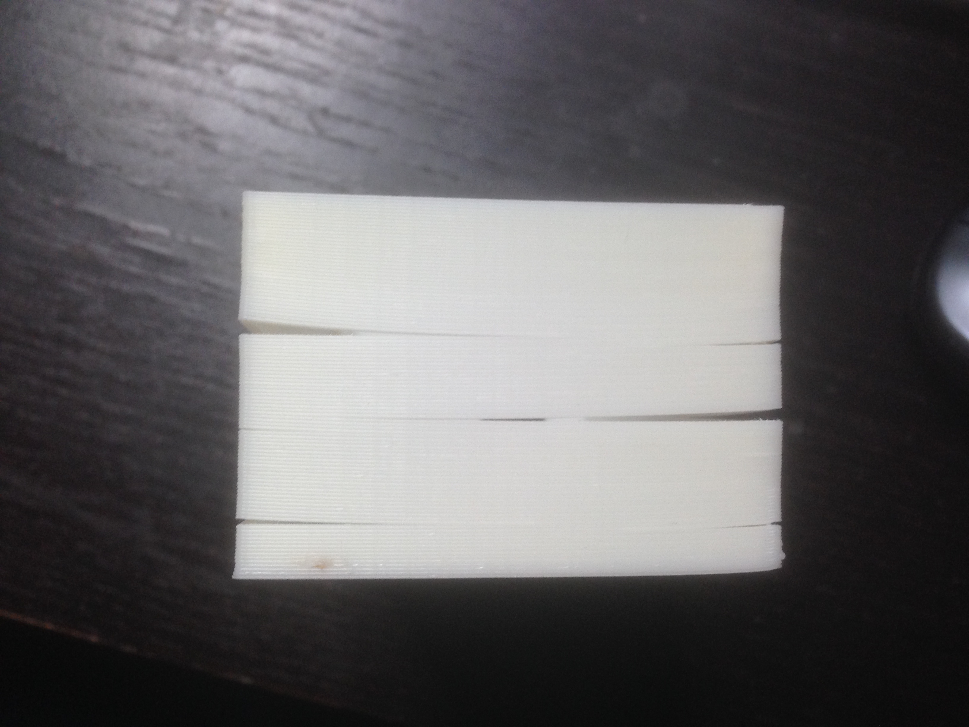

I thinks I have a very typical problem with crack on ABS, I searched in this forum, seems the most common suggestion is to increase the extruder temperature, but some said it is too risk to damage the extruder.
I'm using Orion and the default setting.
Thanks for any help! And looking forward for a ultimate answer for ABS crack/curling problem.

I run my extruder at 235C for ABS.

that cracking typically happens if you are running the layer fan with abs... make sure you have the layer fan off

How cold is the room where you keep your printer? Try printing with the workspace covered/enclosed, maybe with just a cardboard box for starters. I had my printer in a room at 20-21C, and I had similar cracking problems.
Alternatively, if you have a small space heater or lamp lying around, direct either towards the print workspace and give it a go.

Thanks for your reply, I'm preparing to increase the temperature as well, just worried as some others said, this will damage the extruder quick. So how is your case? Does the extruder last long in 235C?

The room temperature during the printing is similar to yours, I agree the dramatic cooling down is the cause, how is your result when you using assistant heater source?

My printer has about 70 printing hours on it and it has only done ABS @ 230C to 235C. So far so good. I do have a replacement PEEK Tube however just in case.
With the PEEK Fan running I believe that it will be okay.

I have a lot of hours on my Max, I print ABS in the 240-255 range, sometimes with a fan despite conventional wisdom, but I'm not using the stock hotend. I find much lower than 240 and layer adhesion is questionable.
