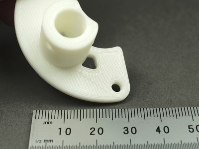

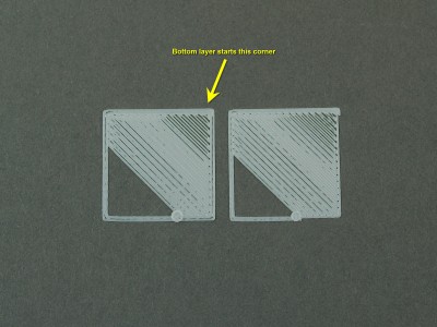

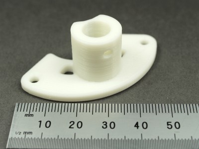

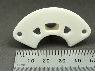

Alright, I think I've got this thing the best that I can get. Still not happy with the bottom surface but I've managed to get it a little better. In S3D I'm pushing the first layer down into the plate a little more. About 83% of my layer height (.18mm). Plus, I've opted for an even slower first layer speed. Plus, I'm going to start setting my z-height just before every print again. I used to do that and got away from it. I am going to bump the retraction upward a bit more. Maybe 3.5 or 4mm. Here's what I have...
Re: E3D V6 Hot End Thread
That looks good to me. I assume you have tried the other slicers and decided on S3D?
Yes. I use a few of them. I bought Kisslicer. I donated for MatterControl, I use Repetier for machine control, and Cura on occasion. All of them have pros and cons. S3D is my favorite but it's not perfect.
