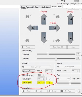

So what does the retract button look like?
- Posts: 1407
Re: Using retract to change filament
Here's a screenshot of where it is on the Manual Gcode tab of Repetier.
