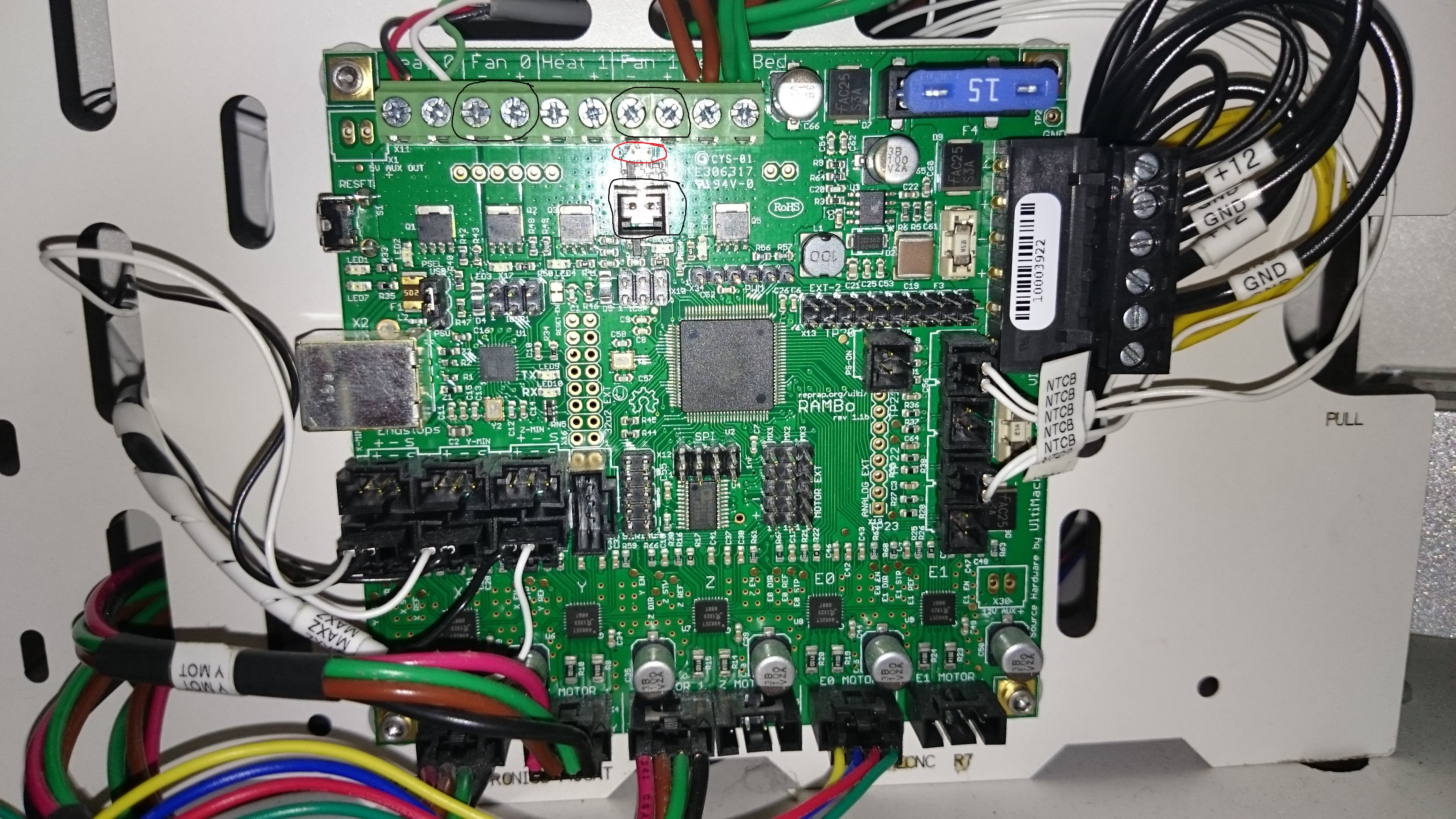

also if anybody have a rambo v1.1b would you be so kind as to take a pictur of the board? just so i can se how the wires are placed. thx again.
i have drawn som black circles on the picture, that is where i measure for power when the fan is on and the heater is hot.

hey Polygonhell.
i just uploaded a picture of my board.
the black "circles" are the places that i mesur for power when all is turned on in repetier. and with no luck.
the small red circle seen on the picture have never been on or blinking.
all 3 fuses are fine and the printer prints pretty well. except for manually turning on and off the cooling fans all the time, and sometimes during a print... (that sucks).

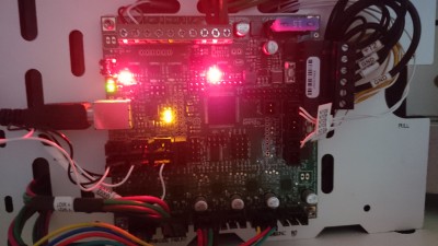

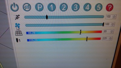

as you can se on these 2 pics the fan is on and set to 100% but there is no light on the board...
also you wrote: There are LED's under all of the Mosfet outputs on the board.
i can only find 1. i know that im a noob at this, but i should be able to count to more than one... lol... (am i looking in the wrong places?)
so if what i shown you is correct, then that only leaves the firmvare.... how do i check that/upload som new?

that pic shows the hotend on, and the heated bed on, but not the fan.. are you able to send manual commands to the machine? if so, send M106 S255 to the printer, that would manually turn the fan on, and see if a red LED lights up next to the far left one... from what I'm seeing your fan isnt being turned on...

hi guanu.
just tryed that. m106 s255. turns the fan on in repetier, but no new lights flashes...

What result do you get from the M115 command? That should tell you what version of firmware you have loaded. I'm guessing you're currently running whatever was there when you inherited it.
The LED's are all labeled LED# on the silkscreen, and some of those are legible in your picture. They're surface mount LED's, so they look very similar to surface mount capacitors when they're not lit. Two of them are on in your picture (the bright ones with the red halo -- they probably look more red to the naked eye).
