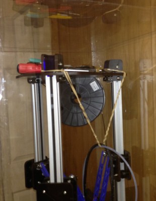

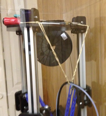

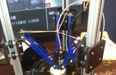

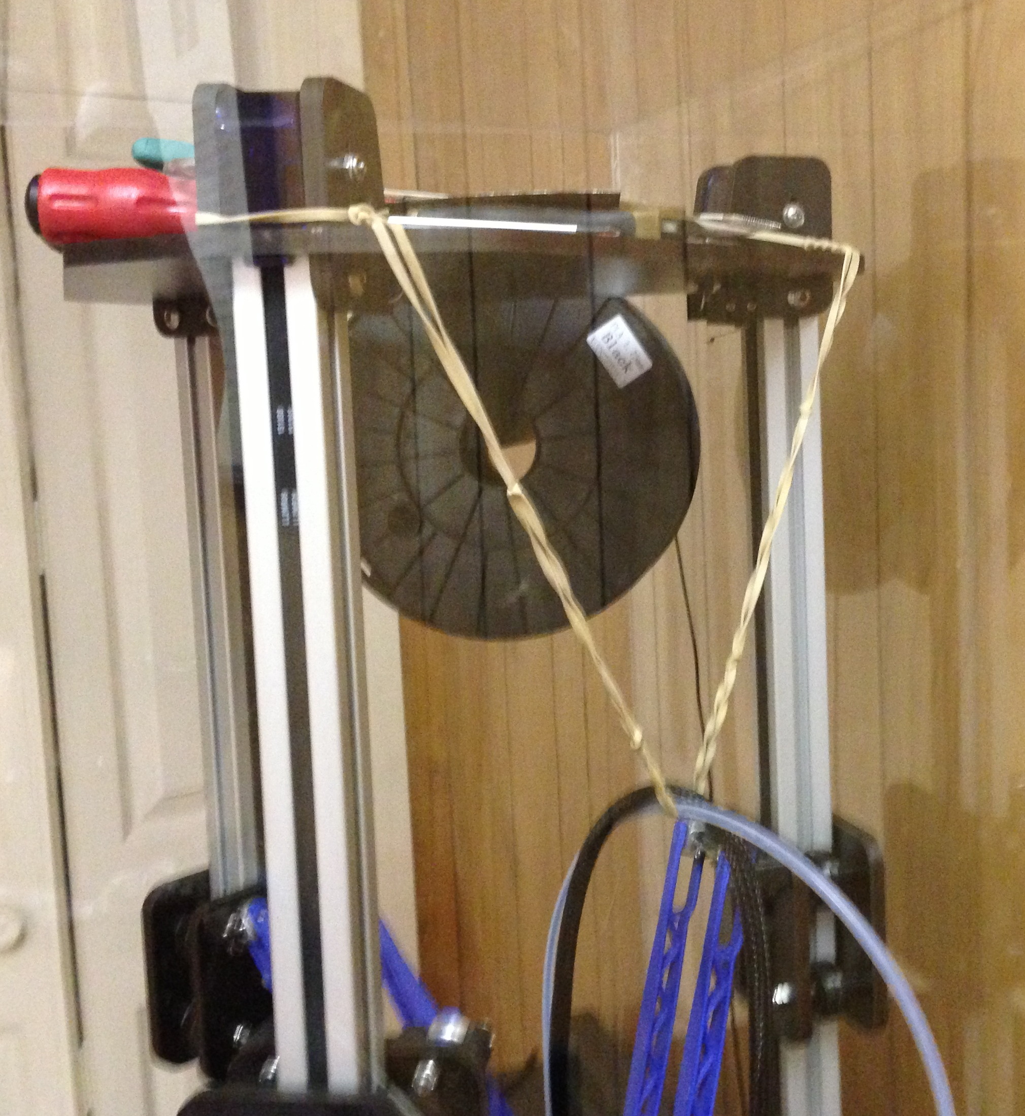

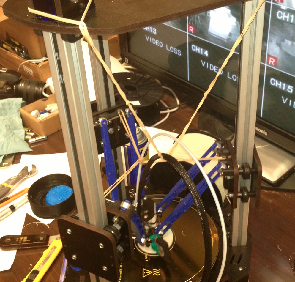

I replaced the PTC's AND the feed tube. SeeMeCNC sent me a slightly longer tube, which I clipped down, but left aabout 8" longer than their original, and (IMHO) its better.. it doesn't bend nearly as much when the head is retracted, and gives a far more graceful loop for the filament to travel. (see pics below)
I pulled the PEEK fan out with it's 3d printed shroud, cleaned the fan (it's been running for weeks non-stop as we've been knocking out prototypes), and put it back in. it's been making a god-aweful whine for close to a month, which I've been putting up with.. after the blowing it out, that seems to have quieted.
Additionally I hand trimmed down the shroud that SeeMeCNC had included (which was warping the fan and partially causing that whine) - apparently they were in a big rush to ship my printer, as it originally arrived missing minor parts.... Makes me think they are pretty slammed to meet orders, but didn't exactly give me a tremendous confidence.. (That said, they *HAVE* stepped up to replace the tube & connectors, although they provide NO phone support and little/no email support, and they did send me out replacement parts which arrived broken in shipping on the original unit).
I'm not about 45 minutes into a print, and it is as good or better than any previous, in terms of quality.
Pics of longer filament line...
the reason for the rubberband "redneck ingineeerin" is that when the unit retracts, the longer tube has a tendency to flop over onto one of the arms, and would get caught by it.... this hillbilly setup keeps the tube upright all the time and actually keeps the feed angle at a minimal amount of bend...

So your new tube is around 27" then, correct?0rionN00b wrote: I replaced the PTC's AND the feed tube. SeeMeCNC sent me a slightly longer tube, which I clipped down, but left aabout 8" longer than their original, and (IMHO) its better.. it doesn't bend nearly as much when the head is retracted, and gives a far more graceful loop for the filament to travel.
Re: Why is my Orion making sploogies??
TFMike wrote:So your new tube is around 27" then, correct?0rionN00b wrote: I replaced the PTC's AND the feed tube. SeeMeCNC sent me a slightly longer tube, which I clipped down, but left aabout 8" longer than their original, and (IMHO) its better.. it doesn't bend nearly as much when the head is retracted, and gives a far more graceful loop for the filament to travel.
yes, my tube is about 27"..
This created another issue, which (mcgyver here) required more duct tape & rubber bands....
THe issue is that if you make the tube TOO long, it flops over.. And when the head retracts, it may (or may not) catch on one of the wheel trucks....
My solution was a bunch of rubber bands.. I looped them together into a LONG loose "harness", hooking each end over the top of one of the leg tops, UNDER the bowden tube & wire harness), and back up to the other...
The result is that when the head is fully down, the rubber bands keep the wires and the tube upright, but when it's fully retracted, there is essentially little/no pressure on the tube & harness.
here's a quick shot....
