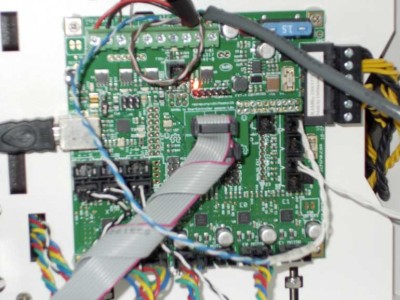

I am still having issues with my hot end. I replaced the thermal resistors with heater cartridges but they are not heating either. Any insight?

my red LED is NOT on

here's a pic of whats happening

Have you blown one of your nano fuses?

I had this problem earlier this year after shorting out my hotend. It was one of the microfuses. In Australia I could only get them online in packs of 10, so I have enough in case I make quite a few more mistakes :)
