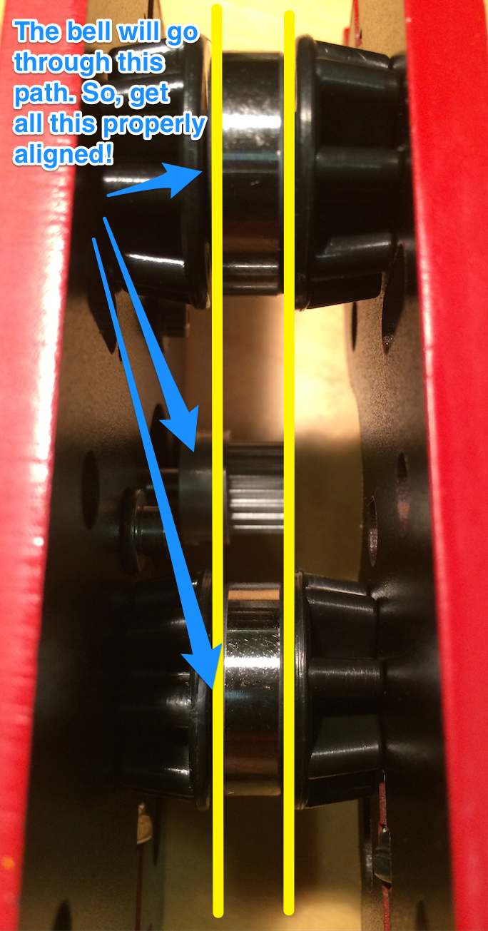

Installing the Motor Dampers (from Tricklaser ;-) )
With and without damper
See the difference between the two motors
The motor with the damper is "higher"
To compensate the width added by the dampers, you will need to place the Hobbed gear not aligned, as Geneb's manual indicates, but a little up.
Pulley perfectly aligned with the belt path (I jumped some steps ahead!)
Everything in line
Everything in line
Belt Path
Follow the yellow path (Oz?)
Be sure to place the damper in the screw, as well as washer, (first washer, then damper)
Be sure to place the damper and washer!

This is the gap that has to be left to compensate the width of the dampers. If not, then the pulley will not be aligned with the belt.
See the gap, to compensate the damper!
This close or is OK? :-)
Close look
Close look
All step motors ready on one side
ready!
ready!
And now ready on the other side as well
Set ...
Set ...
... and now, steppers mounted all the way in their place ...
Go! all stepers mounted in the base ;-)
Diferent Angle
Diferent Angle
