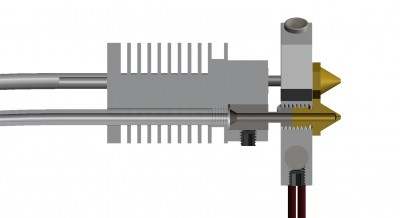

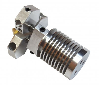

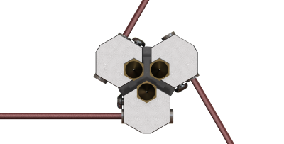

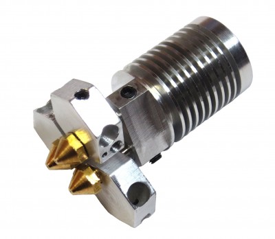

Hi everyone! I bought my Rostock Max just over a year ago and ever since then I've been working on 3d printer related technology, some of which I've posted on these forums. Anyway, this particular post is about something I've been extensively developing since the beginning of 2014 (although I started conceptual work on it in early 2013). I considered doing a Kickstarter but everything on Kickstarter is delayed for at least a year since the crowd investors need to have their orders fulfilled and stuff. So I decided to start small when I release it, and I'm giving you guys the first look at my product since I've relied almost exclusively on this forum for help, advice, and research.
The Tri hotend;
Bottom view render
Cross section render
It's just three hotends rolled up in one. No PTC fittings, no melting PEEK sections, no bowden backlash, no multi-extruder alignment shifting.
I'm going to start selling these within a week (unless something goes horribly wrong), and if there is enough demand, I'll ramp up production. I want to keep this thread as design and feedback input, as well as discussion, not as an advertisement. Nevertheless, there are several users on this forum who started businesses selling aftermarket 3d printer parts, so I don't think that I'm out of place here. My first hundred and ninety something posts on this forum weren't spam ads.
Give me feedback! I have good prototyping capabilities at this point and I want to know what you want in a hotend. My business plan is to make niche products for the DIY 3d printer crowd, so if there are even a few people who suggest I make something, I probably will. Open source, of course (although manufacturing drawings won't be released until I break even). It's not for sale yet and I won't post the link to my website on this thread.
Please give me any comments, suggestions, questions, inquiries, ect. in this thread. Thanks!

So you mention that it has no PTC fitting and no Bowden lash which got me looking at your pictures very closely... It looks like the bowden tube itself threads into female threads inside the aluminum, just above the heat break... Is that right? How has that been working for you, I'm intrigued.
Looks very cool!

Yes, the bowden tube threads in just above where it enters the heat isolator (thin tube).
It prevents the bulk and problems associated with PTC fittings. This is how I got three nozzles in such a compact area. I can pull as hard as I want on the PTFE tube and it doesn't wiggle at all. The three holes that go into the top of the heat sink aren't threaded most of the way; the tube slides down freely until it gets to the threads. They're threaded longer than an M4 nut but not so long that it takes forever to screw the tubes in.
The only negative part of this design is that the ends of the bowden tubes need to be reamed/drilled once they're threaded into the heat sink, otherwise the compression from the threads causes a tight fit and extra friction on the filament. This hole enlargement will be done on my side so you don't have to worry about it when you get your hotend. It only has the potential to be a problem if you use a direct drive extruder (ie EZStruder) with not enough power, and you cut your bowden tubes. I plan on shipping with the tubes already inside and threaded and reamed. Gear driven cold ends are no problem, and when I make a 3mm version i won't have to deal with it since they use 4mm PTFE tubes.
It only has the potential to increase friction if your filament is oversized/inconsistent. Trimmer line slides freely with or without reaming. Once it's reamed, everything under 2mm slides freely.
By the way, exactly how long are your bowden tubes for those of you using a stock SeeMeCNC Rostock Max with the EZStruder? I still have a Steve's extruder mounted to the top plate of mine!

Smart design, I particularly like how all 3 nozzles are so close together and have a small through effector footprint.
Generic Default
Posts: 554
Re: Tri Hotend
Post by Generic Default »
Keeping the nozzles close together was one of my main goals in this design. I have had two other hotends since the end of 2013, but I can never get them working for dual extrusion because of alignment and leveling problems.
If the effector plate tilts at all (which is does on any machine) the nozzles will not be level. In my case, one nozzle would be high on one side of the build plate, and on the other side the other nozzle was high. Even 0.05mm makes a big difference, enough to prevent decent prints with dual extruders. The angular tilting of the effector plate is minimized if the nozzles are very close together. On the Tri hotend, the nozzles are just over 10mm apart. They also don't wobble relative to each other during movement even if the effector plate isn't perfectly rigid.
The triangle part of the heat sink is under 25mm in diameter, so it should work fine with the rostock max effector plate. The heater block sub-assemblies slide into the heat sink after the heat sink is mounted on the effector, and they're leveled by dropping them onto the build plate.

This looks amazing, can't wait for you to start selling them. It's not oversized and it looks extremely sleek.
Generic Default
Posts: 554
Re: Tri Hotend

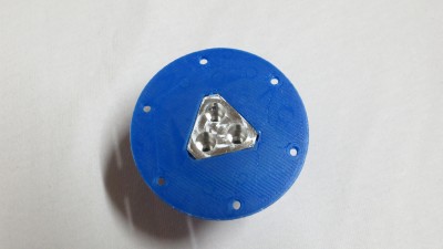

It's actually pretty tiny. It uses less than 20mm of Z height under your effector plate, and 30mm over it. The mount is very compact. Check it out.
That's the adapter for the Rostock Max effector plate. You just press the Tri hotend into the adapter, put the adapter in the effector plate, then put screws through the holes to hold the adapter in place. The heater block sub-assemblies slide into it from the bottom and are locked in place with set screws.
