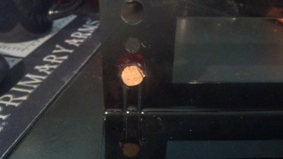

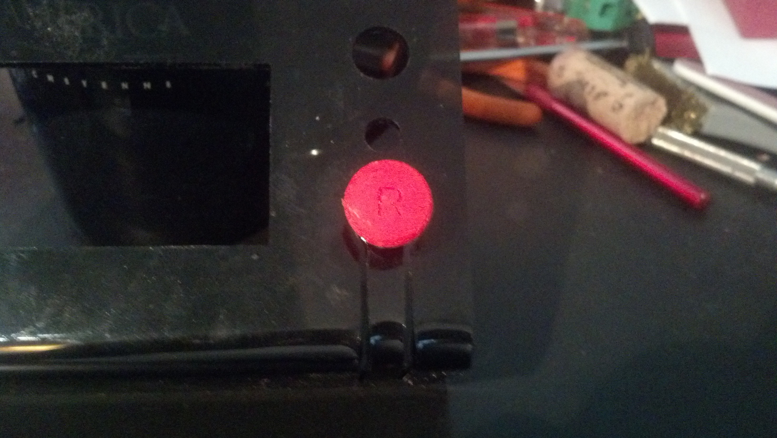

I have never liked the RESET on the base of the RMV2. You have to push it in too far and the plastic tab will likely stick in the opening. Not thought out as well as it could be.
Seeing this as an opportunity, I decided to "fix" it. I printed a RESET Button cap that I found on Thingiverse and fitted it to the front acrylic front panel. To correct the over travel, I attached a cork pad cut from a wine cork to depress the small button on the LCD Panel.
So far it is working okay and makes it much easier to push the RESET. The amount of travel on the RESET Button can be adjusted by sanding the height of the cork pad.
Hope this helps but your mileage may vary.

I would make it smaller in order to avoid depressing it while reaching for the knob...

I had trimmed the plastic tab with a dremel.

You need to get a small round rubber foot and adhere it to the backside of the acrylic where the switch is, works great!

That's what the cork pad does. Nice thing about the cork is that you can adjust the height by sanding to suit your feel when pressing the switch.
